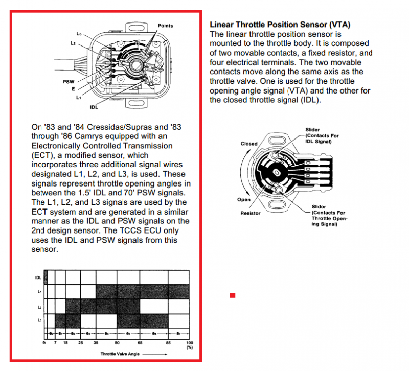

I dug around and came across the following document:

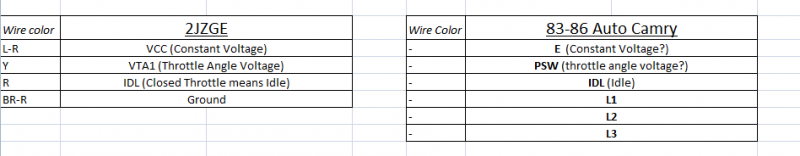

Using the above, I found the pinout of the 2JZGE TPS and made the following spreadsheed:

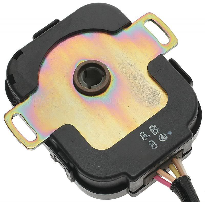

Next is my dilemma. The Cressida TB:

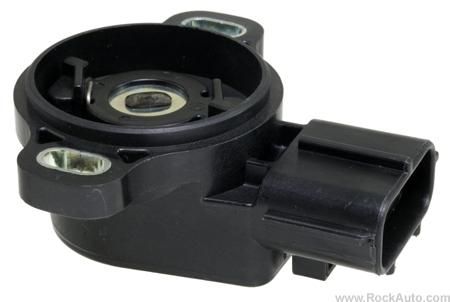

vs the 2JZGE TPS:
Now, if the Cressida TB has the same diameter as the 2JZGE TB at the TB butterfly, I was thinking of a TB butterfly assy swap along with TPS should do but chances are, the dimensions will differ from shaft size, shaft length... you get the idea.
Next, I thought about going to a machine shop to have them adapt the Cressida TPS to the 2JZGE TB but I'm not sure how true the TPS calibration will be, assuming that the camry TPS needs to be calibrated.
