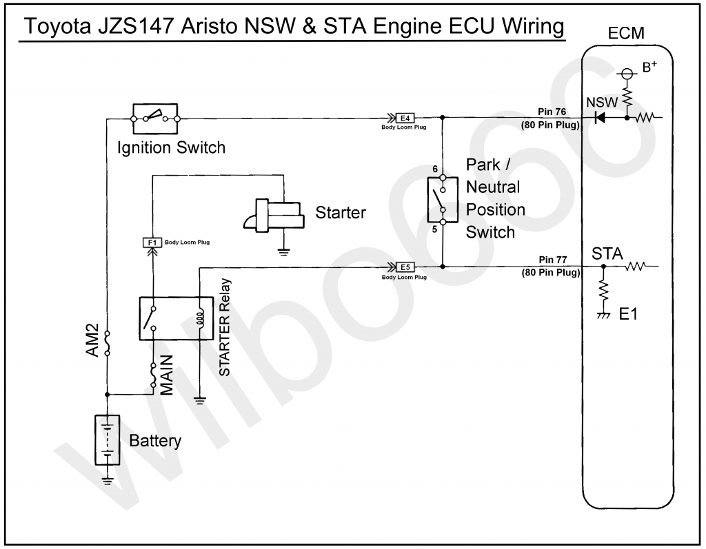

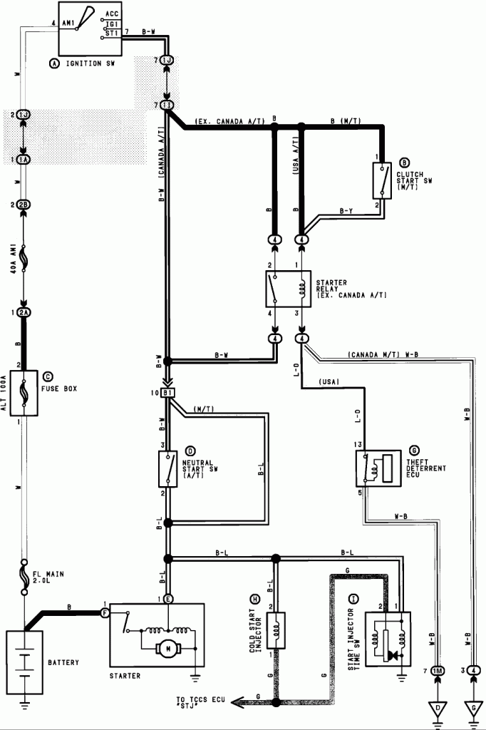

im in the process of extending my harness and am a bit confused on how to wire my starter. where im at right now is I have it wired on my wiring map that I drew out for B1 pin#10 to wire into body plug F pin#1 and that's all it would need to crank correct? well at least that's the way it looks to me on the diagrams.
aristo starter diagram
1991 7mgte starter diagram

Yes, stagger the solder points, so that the harness does have 1 big lump... I actually used different color heatshrink, so that I could tell which bundles to revisit (if I had an issue with 1 wire, etc).
For which signals, I tied to which connectors/pins, look here http://www.supraforums.com/forum/showthread.php?466152-Wiring-Peer-Review-Aristo-ECU-Harness-in-91
The 1st post (wire map) hasn't been updated in awhile, so please verify your pin outs... My Supra has an "auto" chassis, so may be a bit different. There are various changes/updates throughout that thread.

Yes, to stagger the solder points. The wire map/link should show which dash wire/connector (think it's B1 #10), goes to which Aristo harness wire (big plug, I think) for the starter (F1?).

exactly what I was thinking for the starter B1 pin10 to F1. now ive been frying my brain and double checking all the wiring now and ive got a few bugs I cant seem to figured out.
1.)
in my post #12 ,talking about the pin 76 and 77 (the NSW &STA wires) im just going to delete them from their body plugs E4 & E5. now my question is should I solder them together to a ground because I have heard of people saying that they cant rev past a certain RPM (4500 or 5500 or something) and they do this to solve their problem. So is it necessary to do this, or I just heat shrink them off separately?
2.)
also for the ac clutch to work would I just have to wire in the blue wire by the fuse box to the compressor and it should work when I try to kick it on with my climate control button or is their more to it?
Satan
1,594
Tampa
Yes for #2 - Although if using a JDM ECU, you can also wire it for the ECU to control (automatically turn off when a WOT, I think). For simplicity, just connect the blue wire.
Can't remember #1... I'll have to check later.

going over it again. I was thinking of connecting the NSW & STA wires to B1 pin #5, which is the + for the circuit opening relay. so they would be grounded when the key is in the ON position and have power going to them in the CRANK postion to get the motor started easier. Do the NSW & STA wires output any voltage that might feed the B1 pin#5, because looking at the 7mgte wiring diagram it also bites into B1 pin#10 which i will use to feed the starter, or are they just input signals?
