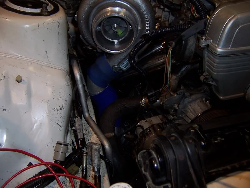

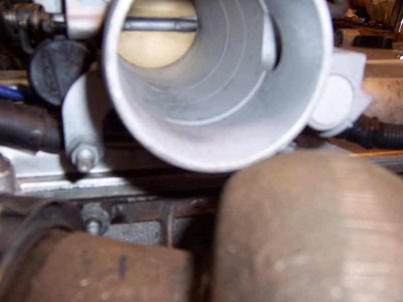

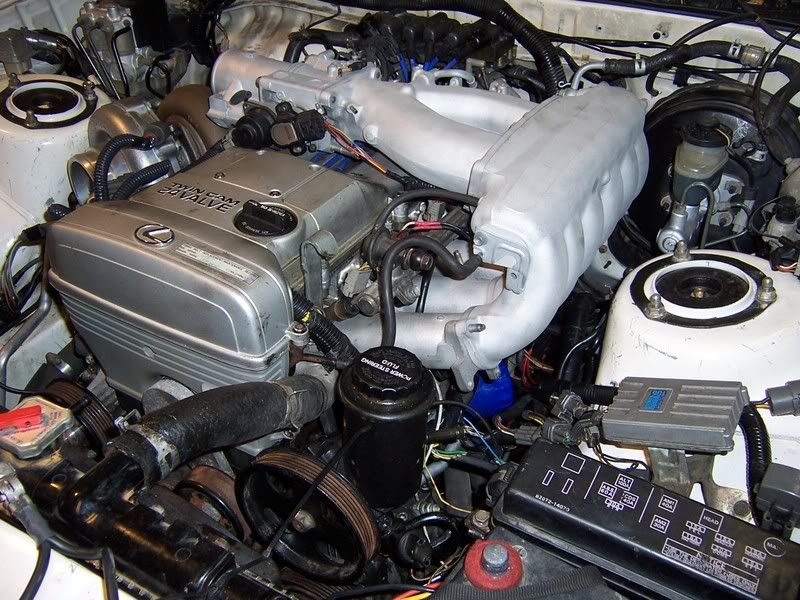

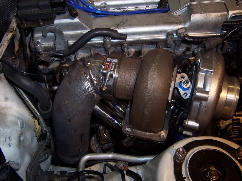

took some pictures today, need to start the last major thing....intake manifold, i plan to build one myself, just need help locating parts...gonna start searching the web for write-ups to give me ideas, its gonna be 4" pipe as a base and probably a q45 TB
Engine
cas, can cut that little bit off?..i probably will anyway :)

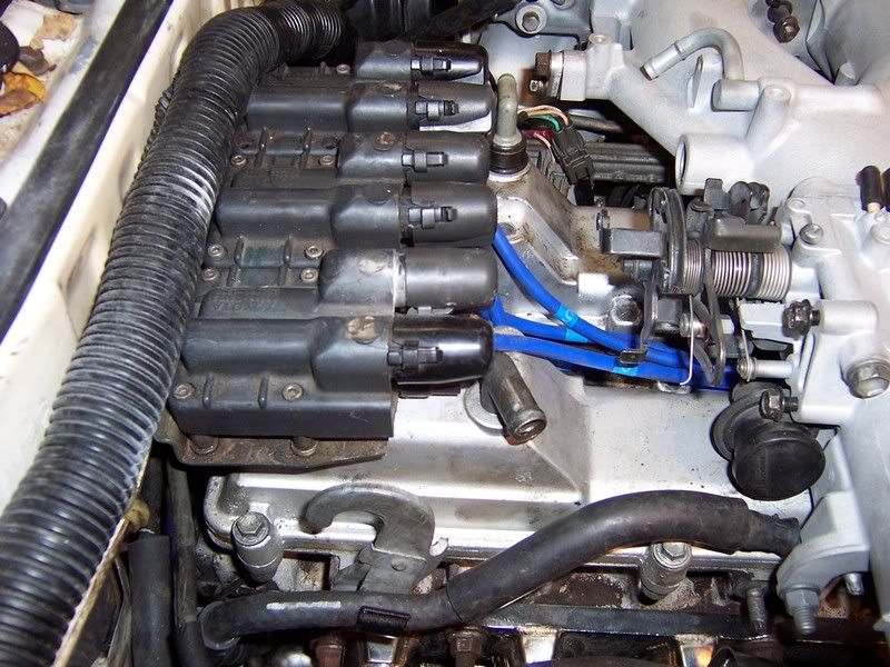

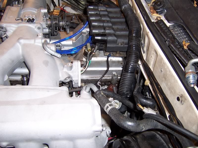

this is were i decided to put the coils, when the intake manifold is done i will lower them into the valve cover dip

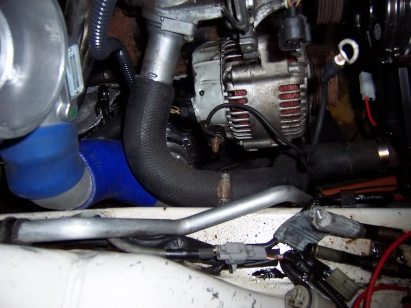

The turbo side of the engine, 4" downpipe i made that just needs the flex pipe added to it, tail bov..probably can't see it but its right behind the alternator

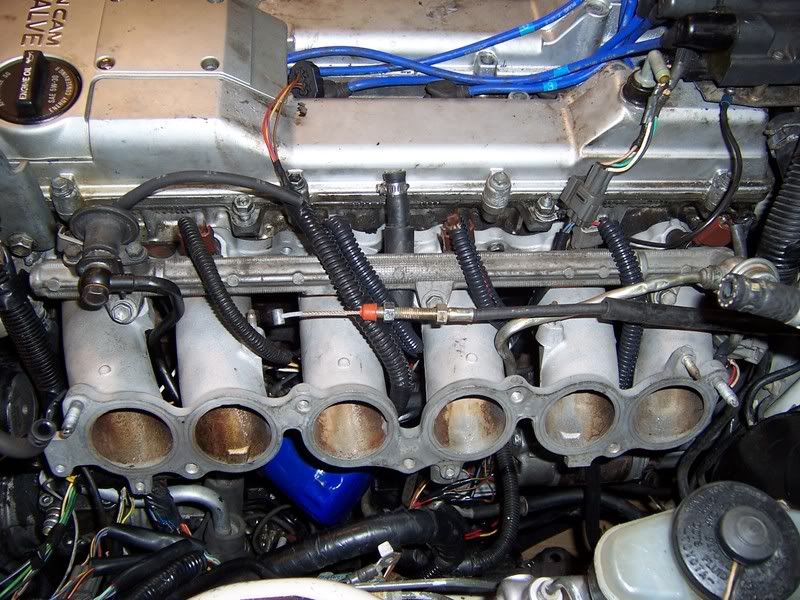

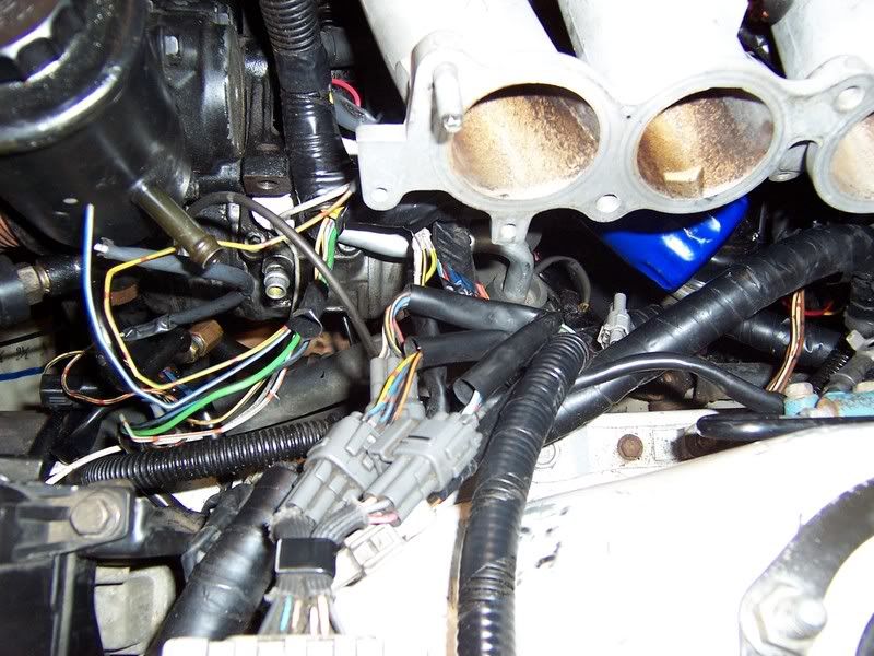

intake side of engine, been done for awhile...just have a mess of wires for sensors that arn't used or i can't hook-up

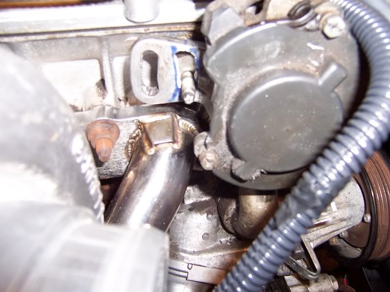

and the major reason for the intake manifold, intake rides on exhaust housing
sorry for big post but some people have asked and i decided to take pictures to rasie my spirits, if anyone has some information on intake manifolds construction or ones that can be had for around 600-700 and are of good quality let me know :)
