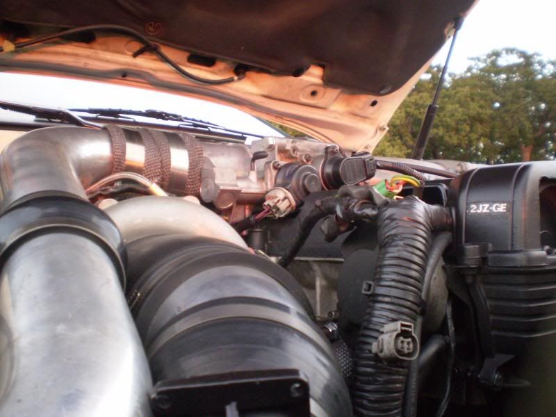

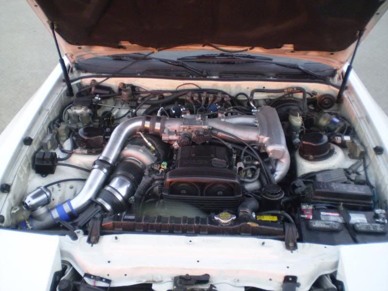

Just thought I'd update.
After driving the Supra around town for a bit, it was time for me to go to school and yes I brought the Supra.
800 Mile road trip in a 2JZ-NA-T Supra completed with ZERO hiccups whatsoever! You better believe I was watching Oil Pressure and Water Temp like a friggin hawk. Filled up twice which was more than I thought I was going to have to. But I got a little lost right at the end of Kentucky which made me have to get gas.
Just thought I'd let you guys know!
BTW I took more pictures at the lake now that it's completed:
Bad Engine Bay Picture:
The Lake:
Ducks...
Thanks to Josh, Scott, Ben and EVERYONE who helped me on this build. I can't think of all of the names right now but I greatly appreciate it!
If anyone has any comments/questions or anything please feel free!
-Nick-
