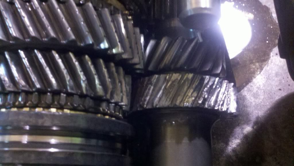

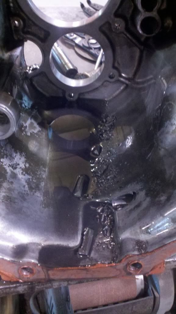

You could try a rebuild and hammer in tight C-clips and build it with super tight clearances and use all the marlin crawler parts. It is what marlin does.
If you have the funds, just go V160 now.

the t56 is def. cheaper though, but i have a buddy that picked up a v160 used for 1200 bucks it was a great deal but had some bad synchros.
