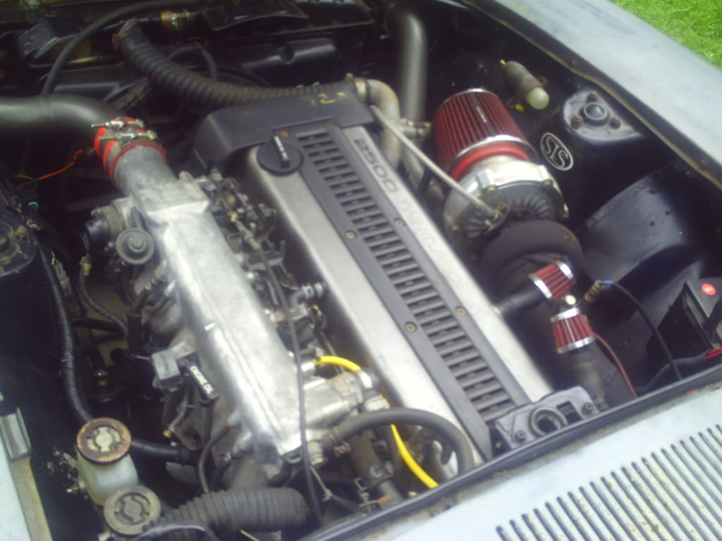

Wow! this car is insanely fast, so far so good. Engine runs like a champ, no vibration in the body so the mount is holding well. I have a couple of issues, i need a oil restrict in the turbo feed line, My car seems to be getting hot after about 30mins-hour of driving the temp goes to about 210 degrees and gets cooler at idle?? I'm not sure what thermostat i have?? I think it's because the Intercooler is mounted right in front of the rad. I'm using the stock rad. so might be time for a new aluminum RAD. I'm going to flush my system and if that doesn't work then I'm getting a new rad.
Did i say how fast this car is? Bark tires in 4th! Thats with the stock 14's though I do have a little lag that I'm not use to; i barley have any boost in first gear, but second is a different story. The 62-1 i have has a 68 a/r hot side that i thought would be pretty quick spooling.. possible Reasons for slower spooling are tuning, ebay crap turbo, or loose wastegate spring...etc
The 1jzgte has a awesome exhaust note, hitting boost revving out to 7k is amazing; 1jz is one of the best sounding engines ever made bar none. If i had to guess this car will run 12's as it sits..I mean at the top of second im already going 60mph+
My wide band is acting up, it reads 15.5 at idle, cruising and under hard acceleration?? I don't think that I'm lean only pushing 10psi.. Im still on stock injectors so maybe i am lean??? Still have to wrap my exhaust and manifold to control under hood temps.. Might install my 440cc injectors tomorrow??? anyway more later

Hard to definitively say whether you're running lean or not, considering I know nothing more than what you mentioned about your turbo, but if you're always seeing the same number on your wideband, you probably have a bit of digging to do. I'm on stock twins, and never run lean under boost, at all, at around 11psi.

WB issue sounds like a fouled sensor, they usually read stoich under these conditions, you can try burning the carbon and deposits off with an Oxy Torch being careful NOT to melt the end of the sensor that can bring them back, or you can swap out the sensor they don't last forever.
Also why beat on the car until you can be sure of what it's doing fuel wise?
Just seems like a huge risk at this point with a high potential for failure..

62-1 .70 a/r cold .68 a/r hot COMPRESSOR WHEEL 57.89 / 72.95
TURBINE WHEEL 54.47 / 83.16
I ajusted my wastegate now it boost to 15psi, then i hit fuel cut..so i might have to change springs to my 10 psi spring

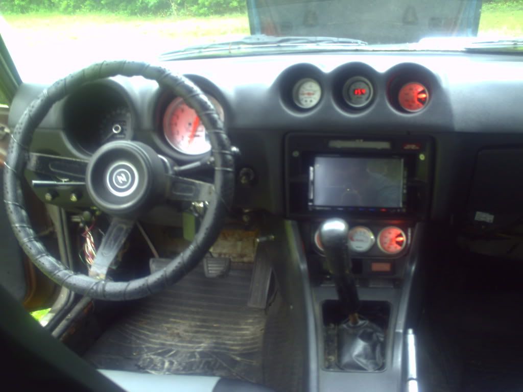

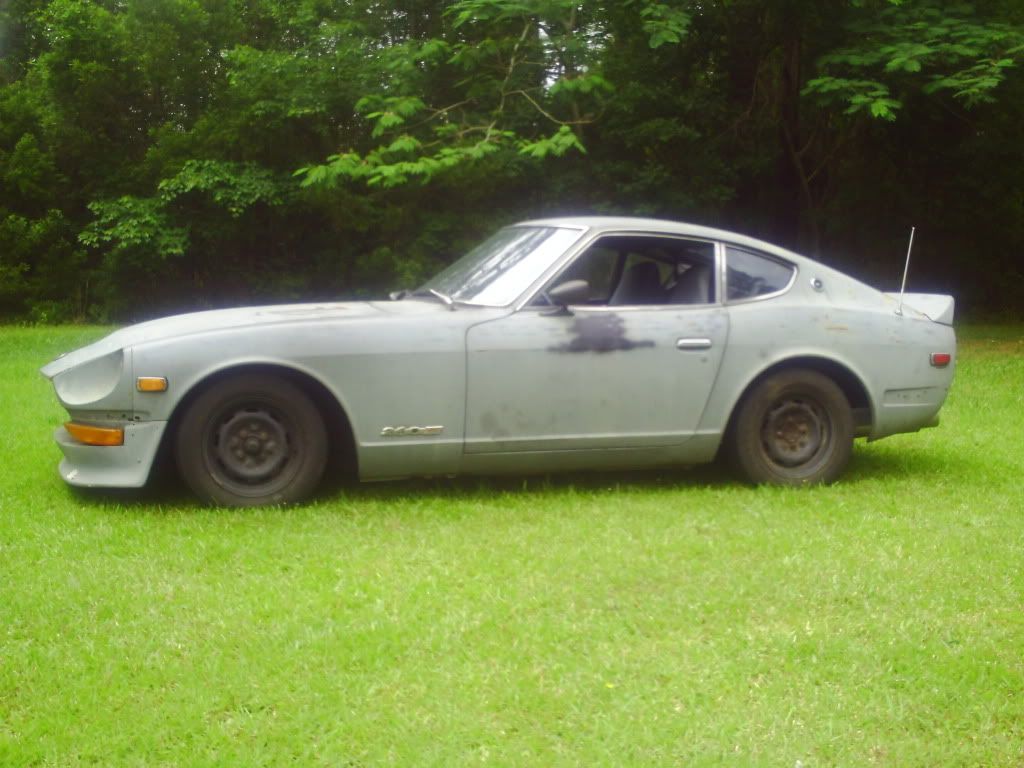

Not much to look at right now, hopefully in a month or so she will be painted..ive got some mkII 14X7 wheels going on until i get some new wheels...money tight right now..
