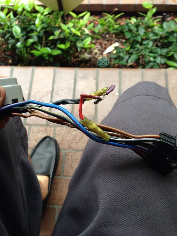

Pulled the ignition switch and found this
it had gotten hot enough to burn a hole in the thick sleeving that surrounds the wiring. The wire that is jacked up is the black/white wire as to which i havent looked up what its for, but picked up a new switch anyways because i don't like the wiring anyway. The car also has a turbo timer in the car which doesn't work and id like to get rid of. Ive never installed one, could that have any issues with the switch not supplying power?

So got a new ignition switch just for piece of mind i knew it wouldnt fix the problem but put the new one in and started checking stuff with the test light. With the switch in the run position, it is still not sending power to the EFI main relay. I tested all the terminals on the back of the switch and the only two wires receiving no power is the Black with white stripe wire, and the brown with red stripe wire. Somewhere from the switch back to the EFI main relay there is a wiring issue.

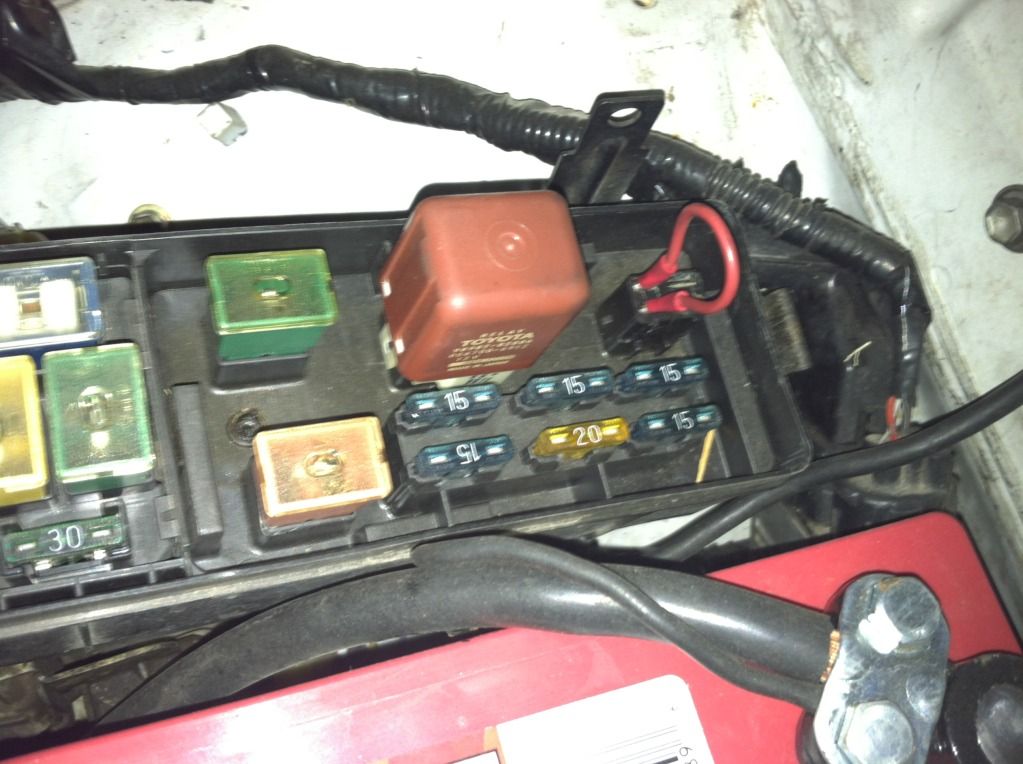

try this. it helped with similar issues i was having on my buddies 1jz swap, no start and CEL issue. it's quick and easy to test.
(jump/bypass main relay) note red jumper wire.
Tried that first, it works just fine, but no offense to anyone that's a half assed way of fixing the issue. Just traced wiring to the fp relay which has no continuity across two terminals. Thanks for the tip, if I hadn't of figured that one out you'd be my lifesaver! Lol
