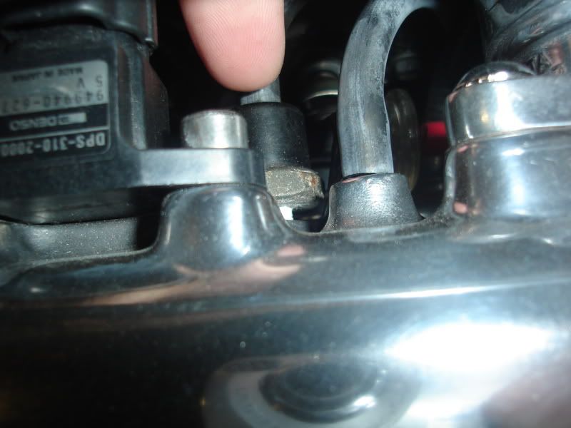

mass
there's a little filter on the intake manifold for the map sensor
my finger is pointing at it

Foreign object damage
Keeps the debris from lodging into the sensor port at 12psi.
Also helps to buffer any spikes in pressure.
The 2JZ one is the same for the most part there is people that argue a 2JZ one picks up more pressure and an upgrade howerver when people conducted pressure test and put them on the same manifold it had the exact same readings through all the pressure scales.
So you know which one I tend to believe.
