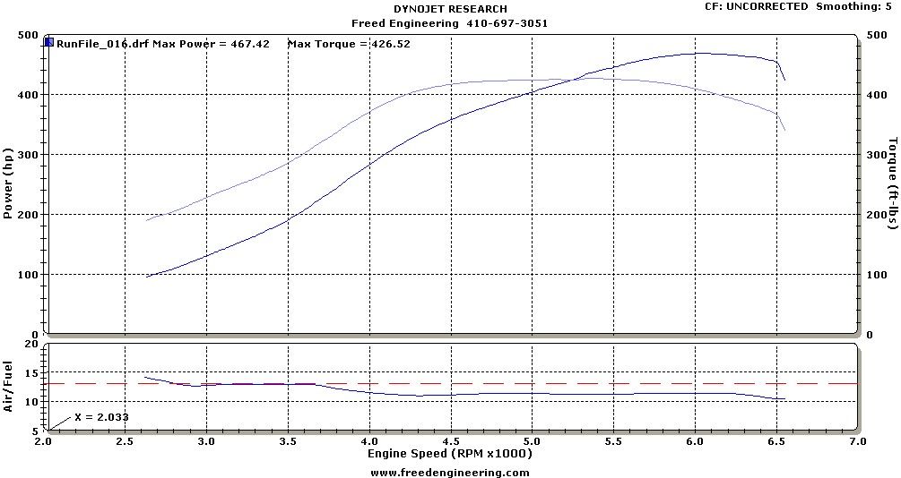

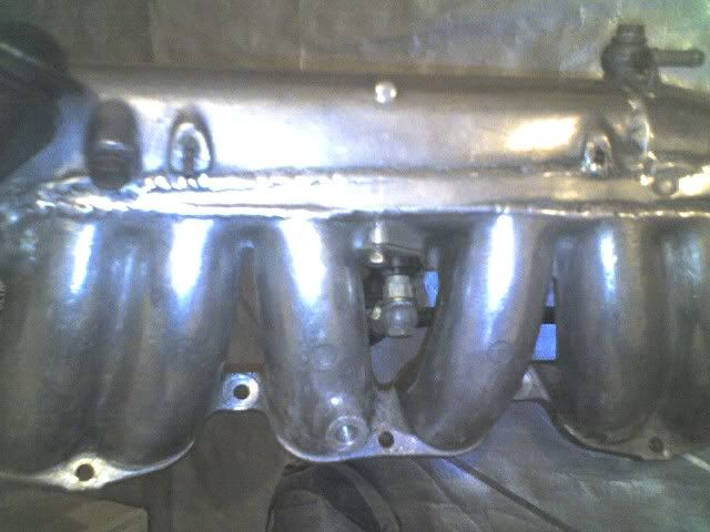

Depends on how you fabricate it. I have the 7M upper runners welded directly into the 1JZ plenum so there is a nice smooth flow. I'm putting down good power with my current setup and the throttle response and spool are great. I'm not saying that a Sethron or RonR FFIM wouldn't be an improvement, but I can't imagine by much.
Here's an old pic before the welds were cleaned up and polished
Here's my most recent dyno
Vid:
[video=youtube;VGeuF48W_CI]http://www.youtube.com/watch?v=VGeuF48W_CI[/video]
Chart:

I still haven't seen any evidence that changing the intake manifold to a FFIM makes any actual power gains.
Lots of people have posted gains, but they always change more than just the intake manifold when they do so.
