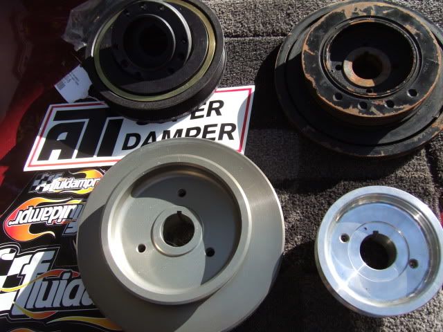

Some of the ATI's are machined really small, so heat up the gear before putting it over the crank.
Since everyone has a preference, I am rockin' the Fluidampr.
