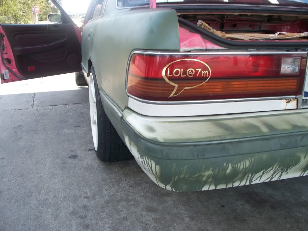

And yes, a 4 year old did paint that bumper.
