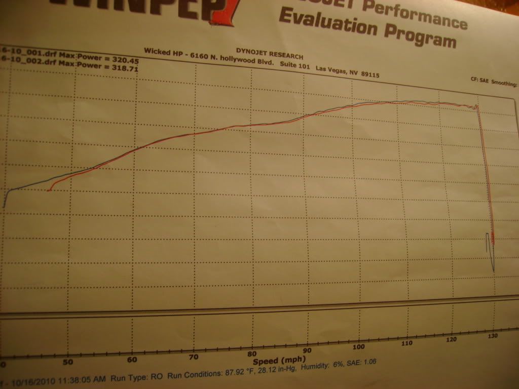

Jordan, I also have the BC264's, been running them daily for just shy of 3 years now. A re-shim will be required with any cam option. On mine, I'm also on stock valves/springs/retainers. You can ask Albert whether or not they fall on their face after 6k. ;)
Anyway, dyno for proof:
I can't wait to see how this thing does with a bigger turbo. Power is smooth, but when it hits about 2800 or so, she starts coming on HARD. I can only imagine the 272's would make the transition into boost a bit more abrupt, but should make more top end power if you're willing to give up some low end torque. I wasn't.
EDIT: Now just a minute here... I just noticed that the guy who ran my car on the dyno that day at SILV2010, only ran it to 130mph. In 4th. With 3.73 gearing. Son of a bitch... Now I'm not sure how much power my car was making, or what the fall-off point would be, because that was only at approximately 6300 rpm. This was according to the Norbie calculator by the way.
