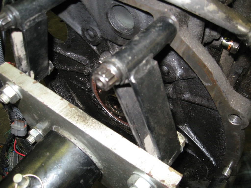

IJ.;1602761 said:
Don't think for a second a 1J uses M12x1.25 hardware to attach the bellhousing to the block so 7M head bolts aren't going to work.....
Really, cause that is what i used.........
7m headstuds, on a engine stand, holding a 1jz
nick88
JayHall's Hero
May 10, 2009
794
Des Moines, Iowa, United States
IJ.;1602765 said:
What size heads do the stock Jz bellhousing bolts have??
(not saying you're wrong just shocked that they went to M12)
Don't know off the top of my head, but my friend told me about it cause he used them on a 2jz.
And TooGoode agrees with me, from my build thread, pic was the one pictured above.
TooGoode;1541753 said:
7m arp headbolts are the one usefull thing from a 7m. they make great engine stand bolts! i use them all the time! they work well for 1mz's and 3vz's as well!
And on my friend James' (*james* is his name on here if you care to know) we used stock headbolts.
