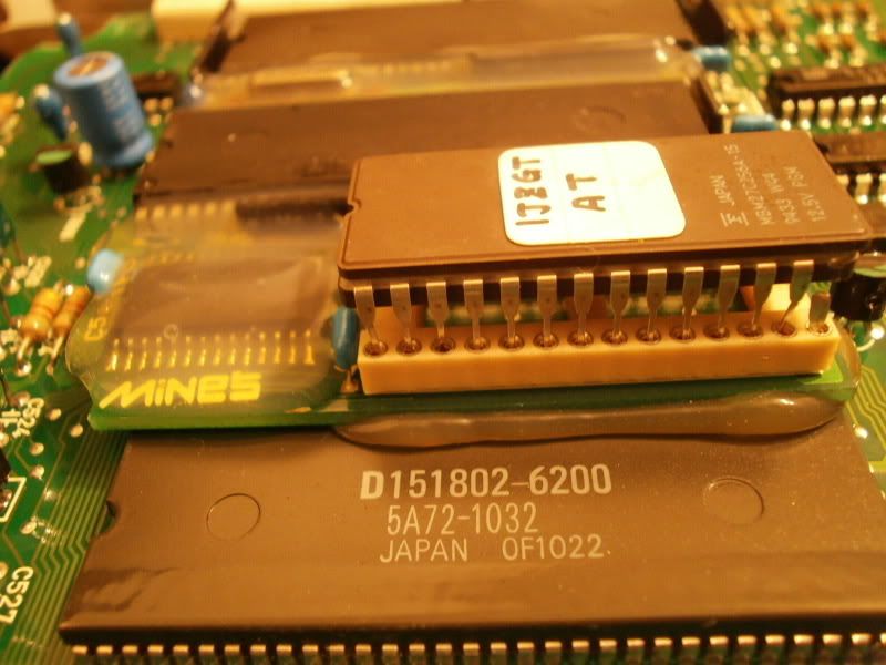

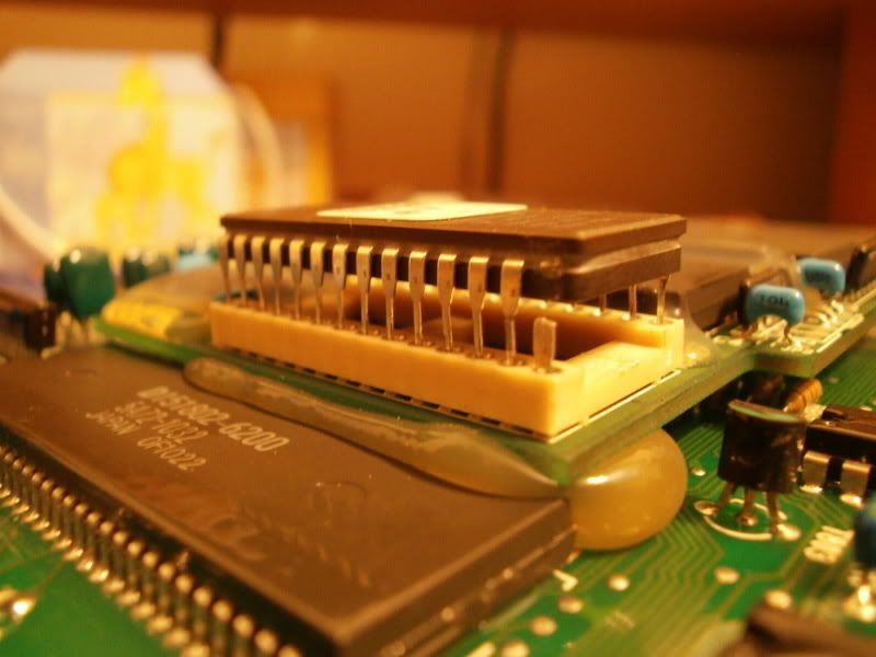

well, after swapping out for a good igniter i decided to pull the ecu, cause its a known issue with 1j ecu's leaking'n stuff
after smelling it and examining it i found this with the Prom chip
so right now my options are 1:get a stock jza70 ecu and test again, or 2: get the harness for my aem, install it and go from there. fuck winter

A Good Tech might be able to reattach something to the broken pin and downlowad the code to another PROM. Cause?, probably wasn't seated right in the first place. More likely previous owner botched a copy procedure and never replaced/handled it properly.

a member on SF said it could either be caused by the chip not being seated properly in the 1st place or alot of heat causing it to crack. I was told i could get a replacement chip, but i have no idea where.
I took it to a cb shop and the tech there said that there is not enough metal there to attempt a reattachment. the heat from the soldering gun would have a good chance of damaging the PROM

Try again. The PROM is identified by the numbers below the MINES sticker. You should be able to google it and find a replacement. It looks to be fairly common. I wouldn't take no for an answear. But if a tech said it can't be done, be assured he doesn't have the skill to do it. The broken pin doesn't have to be physically connected, someone should be able to press a straight pin against the PROM section long enough to download the code. It might be possible to solder a straight pin to the broken (detached) pin and press it to the PROM long enough and secure enough to download the code. NO heat envolved for the PROM. It's a shame to see a $5-600 ECU trashed by a $10 part.
Alternative, Contact MINES for a replacement chip w/code.
