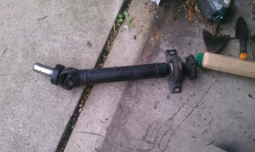

this thread is old, yes.. but I thought I would post some pics of the GENUINE JZA70 shaft taken directly from a TT-R. This particular shaft also includes the newer style carrier bearing (believe the same ones used on certain mkiv models)
this pics are of another shaft, but I have an identical one sitting right next to me as well:
SC300 bearing:
