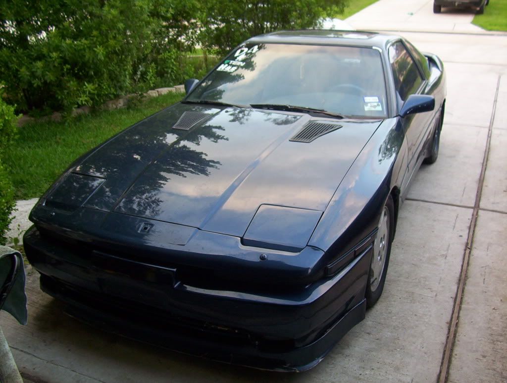

I have a supra shell which i was going to do a 1jz swap in but didnt have the money or time to finish so i started looking for a fair running supra for a daily driver and came across this 1987 Toyota supra turbo 5 speed that has been converted to a 89+. i paid a little under $2000. the last owner said that it has a aftermarket act clutch kit and a light weight flywheel which i believe cause the clutch is pretty heavy. last owner also said that it has a fairly new turbo. it has a tein coilovers too. the supra runs strong but needs minor work. interior and exterior needs a bit work too. will fill in on the details as im going along with pics too.

heres the pics of my find
and heres a little toy for me. lol
more pics to come as i fix her up.

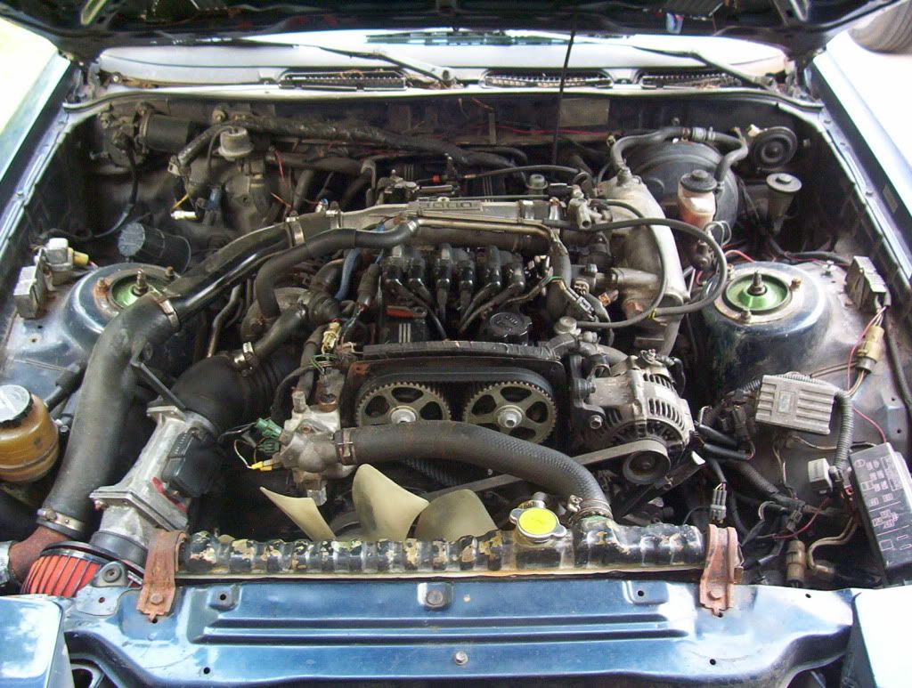

as i was looking into the engine i noticed that the vacuum lines are way off. its also missing the canister for the vacuum lines and a couple lines so she was sucking raw air in(not good). and also there are alot of wiring that dont even belong(oh boy). and also the Oxygen Sensor for the turbo elbow was not tighten down right(eh). and i guess someone told me that this previous owner wasnt running a high enough amp for the speakers hes got in there. but hey that is what a fixer upper is for to find the problems and fix them. LOL.....

Wow the engine bay sure needs some work, spend some time on it and you'll get running sweet I'm sure. Just from the pic's the radiator actually looks just like a ma61 radiator i have in the shed, i could be wrong but it looks to fit funny in the brackets. Also your fan shroud is missing so that won't help your cooling issues either, after fitting a new shroud if the temps persist check for Bhg.
Clamp between the accordion inlet hose and the Afm looks to be missing also, Any stray air leaks tend to make a large difference overall, so do these little (cheap) things first and it will make life much easier for you when you start tuning down the track.
