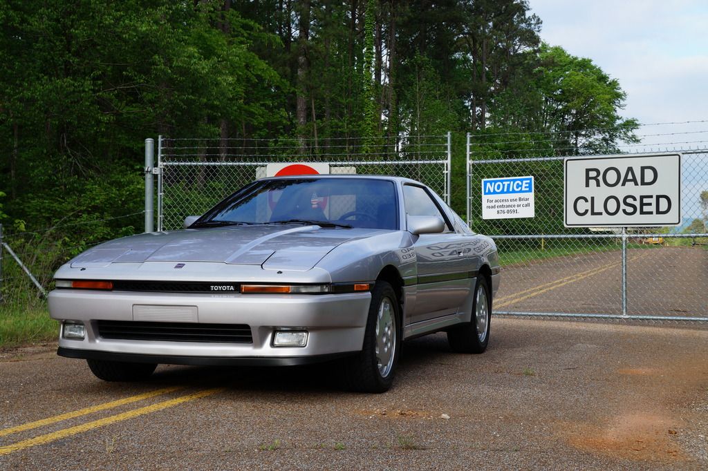

Weird I have none of those problems with my car other than valve stem seal smoke. It's amazing what caring for your belongings will do and doing things the right way the first time...
Here's a fully functional MK3 whose owner doesn't hate it for what it isn't. I feel like this thread needs something nice in it.
