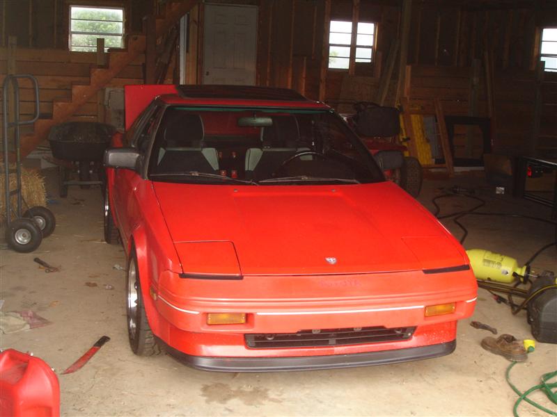

So I havent been around these parts in a while since I sold my MKIII, but I have been busy with my new MKI MR2... Figured I'd give those who care an update...
86 MKI MR2
fitted with 3SGTE
Currently at Speed-Source in Illinois for some serious fab work...
Engine:
je 9:1 pistons
eagle rods
reworked head
balanced and polished crank
TTE metal headgasket
ARP's (HG, Mains, Rods and Flywheel bolts)
Tial BOV
Custom side-mount exhaust manifold/DP/Wastegate setup by Speed-Source
GT3076R
tial 38mm wastegate
RMR intake Manifold
Accufab TB
Greddy T-belt
A2W Intercooler
Reinforced Speed-Source engine mounts
Speed-Source Chassis Mounts
Speed-Source poly mount inserts
Speed-Source Oil Pan sensor Blockoff
Speed-Source clutch line
FUEL:
Aeromotive FPR
Wolfkatz Fuel Rail
Moroso Oil Pan
780cc injectors
Walbro 255
(Final tune will be on 1000CC injectors and E85)
ETC:
stock transmission and axles
Speed-Source Axle Bolts
fidanza flywheel
act stage 3 clutch kit
hks hyper exhaust
ELECTRONICS:
greddy turbo timer
greddy profec spec B boost controller
AEM EMS
AEM Wideband
BRAKES:
New OEM master cylinder, calipers
Porterfield R4S pads
SUSPENSION:
Koni Yellow struts
Eibach springs
New OEM strut tops, ball joints, inner and outer tie rods
Prothane bushings
New Rack
Rota RB 15x7 et30mm. Brand new Azenis RT-615 (this will not be enough tire...)

MOAR PIXZ
fuzzy yummy goodness..... change of plans on intercooler.... care to venture a guess....
gotta love a good teaser.
wastegate mount: more Speed-Source awesome fab work. Carl is my favoritest EVAR!
I also just bought a set of TOYO R888's.... 225 for the rear, 205 for the front.
not my pic, but it'll do.
ArmandoP
Nov 4, 2006
313
Indianoplace
Should be back in Indy next week. I have a tune from a previously built car that we will be using as a starting point... That car had cams though, and it made 390 to the wheels. That will not be enough for long, but it will be enough to start enjoying the car before I throw some cams in and hit the dyno. :)
