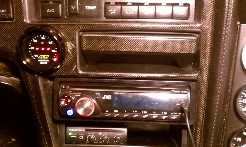

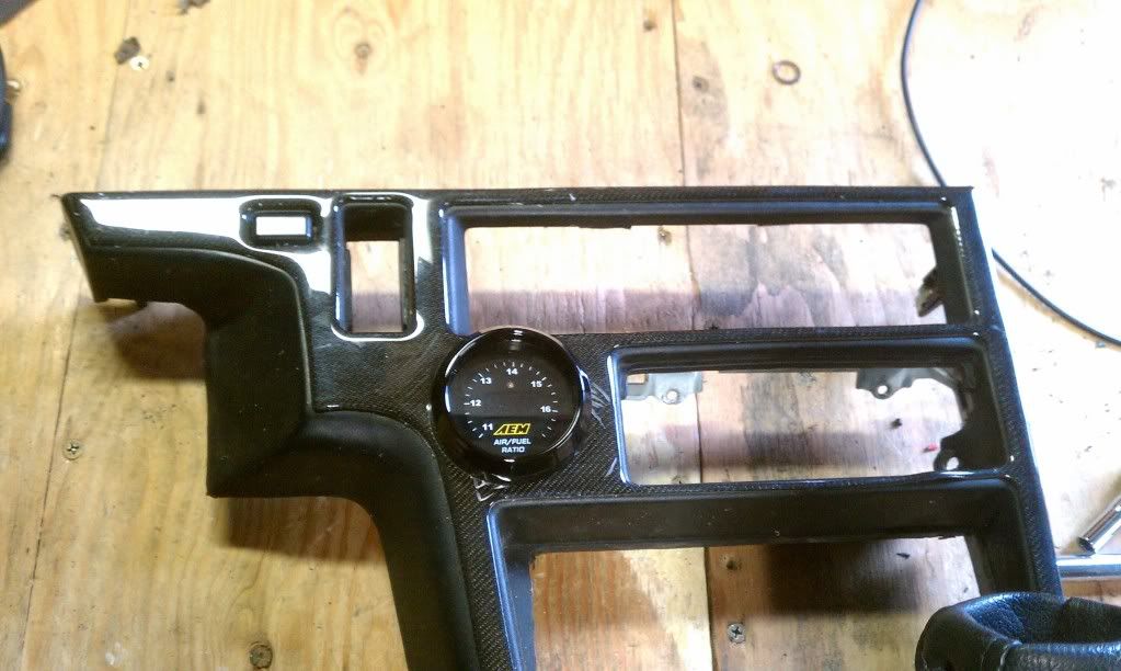

made a spot for my wideband gauge in the dash. i think it looks pretty good there
and in stalled my greddy profec b controller. that thing is sweet\

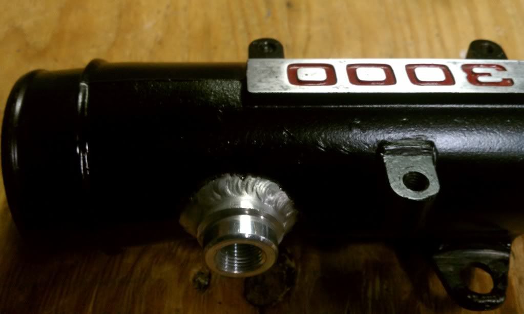

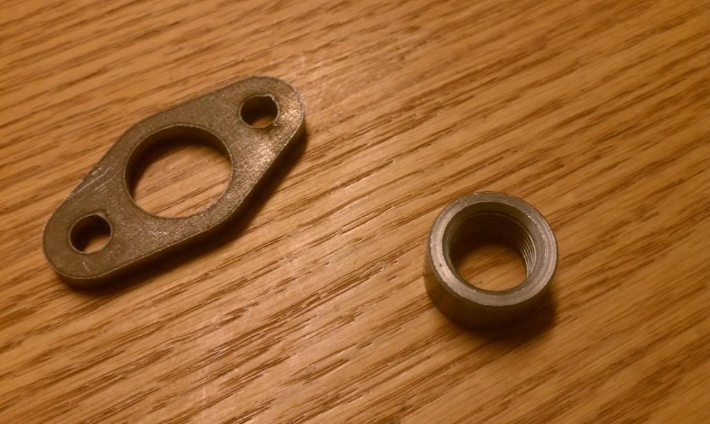

Didn't get a lot done today but bought a 3/8 npt weld in bung from autozone for my iat sensor, welded in, and re painted

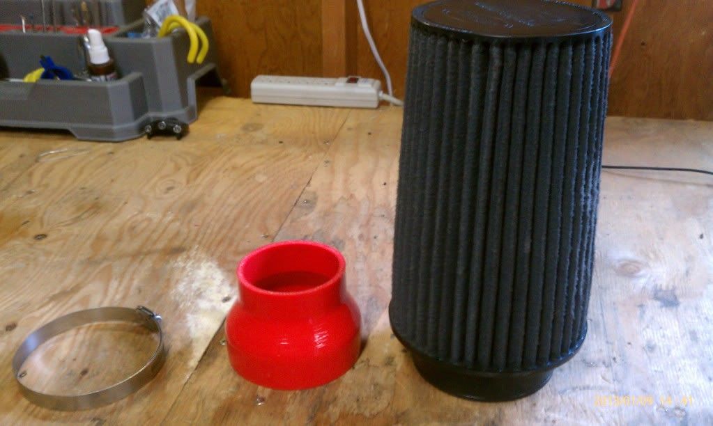

Got a little done today before work, my sillicone adapter came in so I can finally run my aem dryflow airfilter and get rid of that hks knock off filter
As well as rewiring my wideband to maft pro unit, had it backwards before :rolleyes:

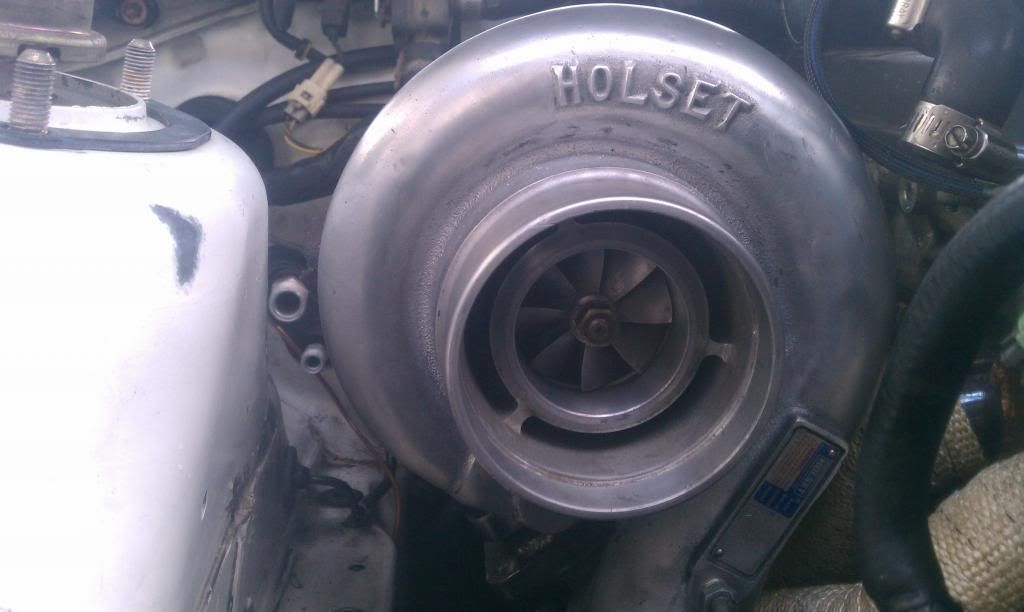

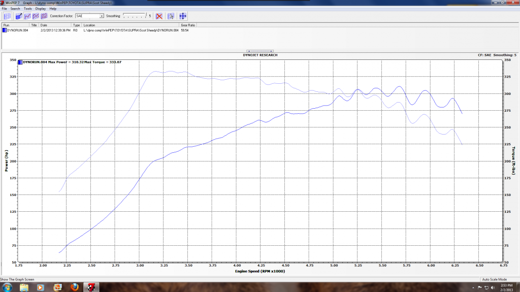

been a little since i made a post so i thought id post some progress. cars running great with kennys tune and put down 310rwhp and 337 rwtqr at 10 lbs. i was pretty impressed, ill post up the dyno pic once i get it uploaded to photobucket again.

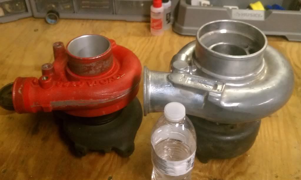

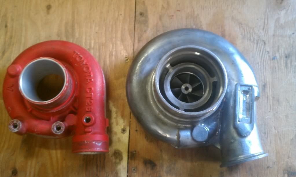

also picked up this holset turbo from a friend of mine, actually he gave it to me. i believe its an HX35w but im not 100%sure, the tag was pulled off the compressor housing.
either way it will need a complete center section which i can pick up cheap on the cummins forum.
next on the list to get is a t3 header, vband downpipe, and some modding to the intercooler lines

just uploaded the dyno sheet, had my boost controller gain setting wrong making my wastegate fluctuate a bit at the end. (10 Lbs)
im hoping to shoot for the 375-400 range with this new turbo, maybe more?

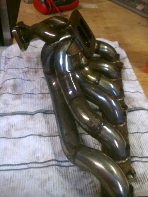

Scored a t4 Header for 50$ on the forum here and a buddy of mine gave me a 3" vband downpipe earlier today for helping him hook up his car stereo!

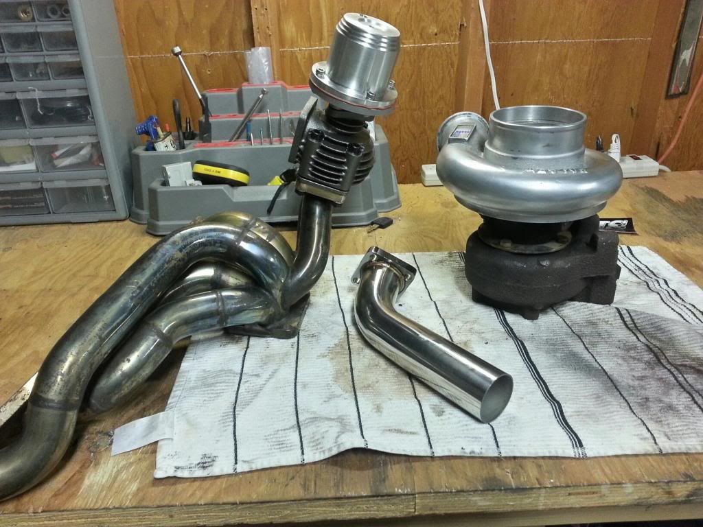

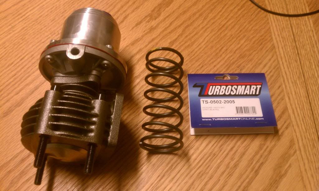

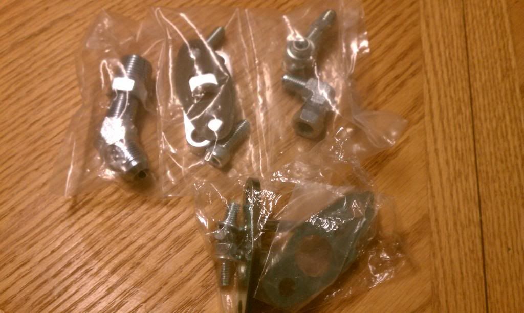

got a few more parts in today, just need a couple more flanges for the downpipe and i should be able to throw the new hx35 on there soon!
hks style wastegate from drift motion along with a turbosmart 14psi spring. Aaron said being longer than the hks one it should be around 16psi

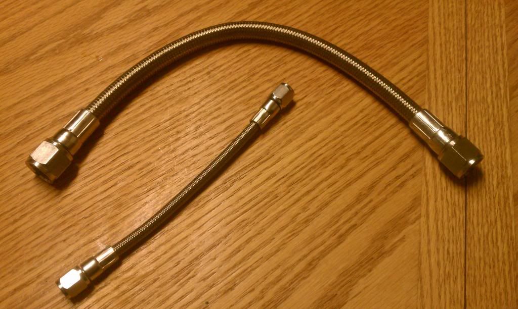

some new oil lines and AN fittings for a easier turbo install

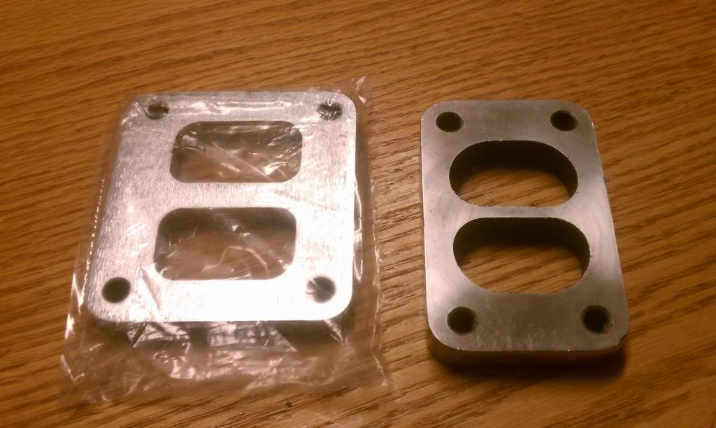

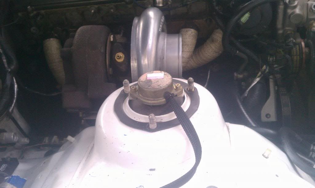

along with a t4 and t3 flange so i can my my own adapter from the t4 header to t3 turbo since the header i have sits the turbo back in the engine bay further than id like it to
o2/wideband weld in flanges for the new downpipe
more updates to come soon!

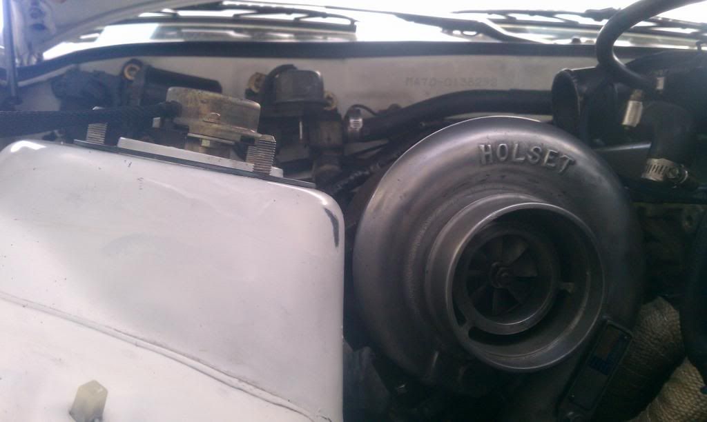

got the t3-t4 adapter riser made and the turbos on!
next on the list is to make a downpipe and finish up the intercooler lines
