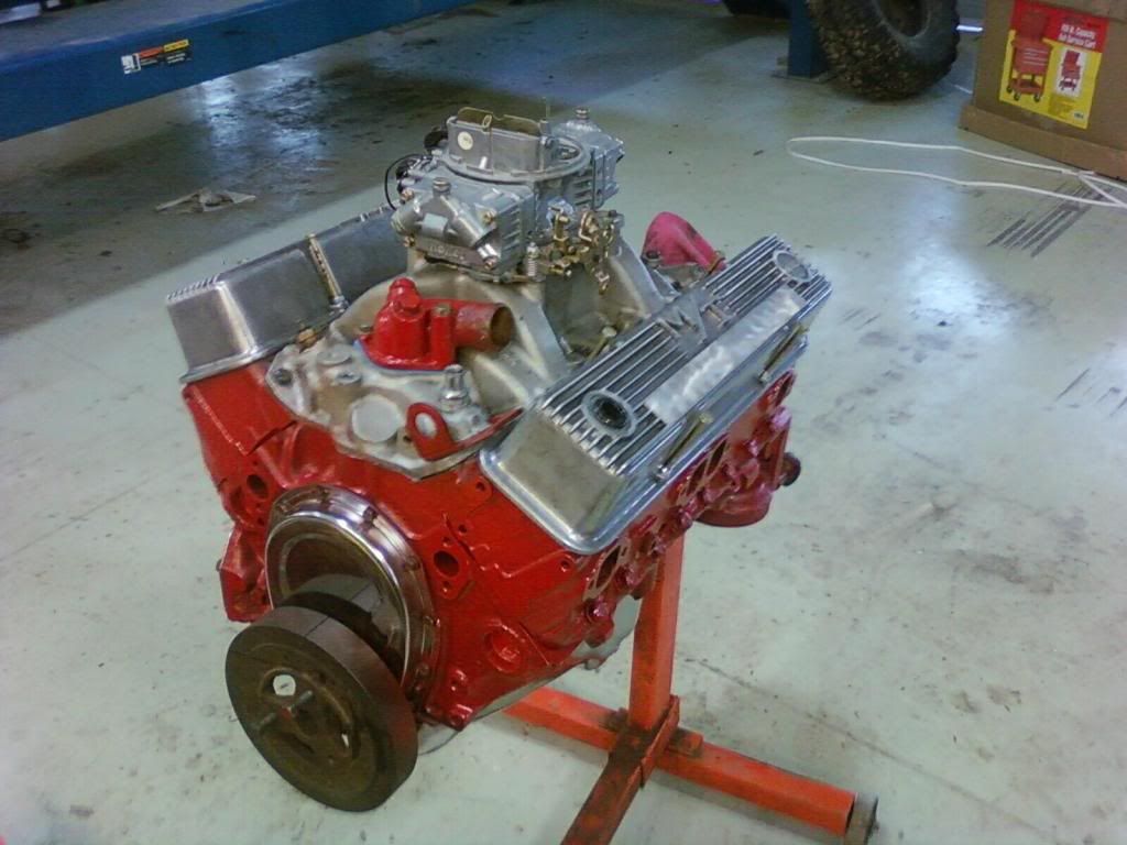

sbc 377, stalled th350 swap.
400 block destroked to 377
forged crank, 6" eagle h-beams, keith black forged pistons... 12.8:1 compression

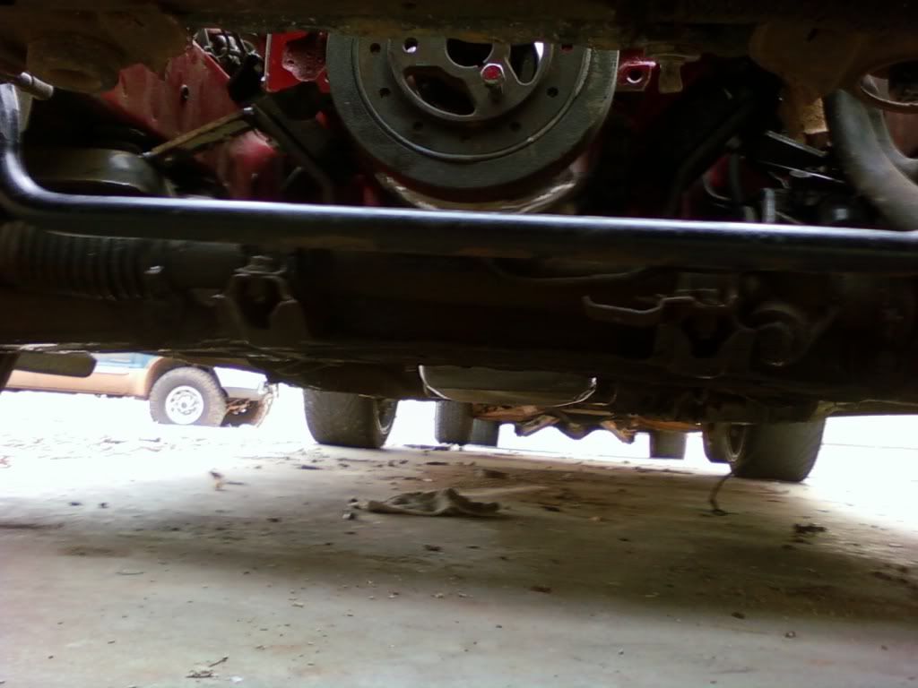

IJ.;1487867 said:
Details?
Pics of the pan and mounts and so on please, which trans, shifter..
Im going to try and make a linkage to hook a stock auto shifter to the th350, if not i have a b&m shifter. The oil pan hangs down about 3/4" more than the factory cross member.

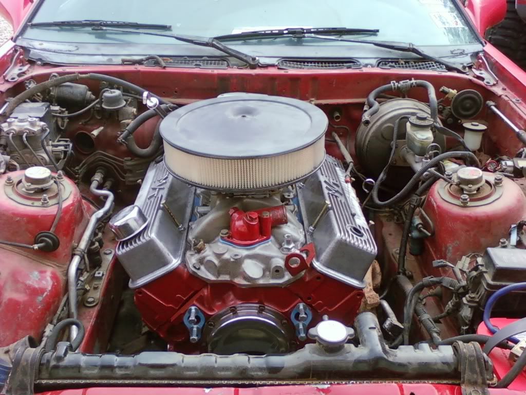

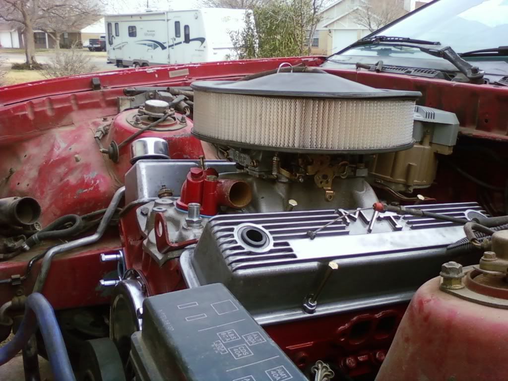

I do not see a plate between the carb and the manifold, I am slightly upset.

To the OP, I am glad you will be able to fit the carb and air cleaner under the hood, I hate it when I see holes cut in the hood to clearance everything. What is the goal of this car?

That was my goal, i wanted to be able to close the hood, another guy in town has an rx7 with an ls1 with a 14" filter sticking out of the hood. It looks stupid. Its gonna be mainly a drag car with some street use. The motor puts out around 550 without spray.
