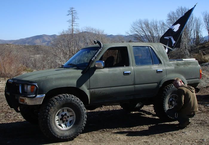

I got my first supra in trade for my 1991 toyota 4-runner (3vze 35" tires)
the runner :

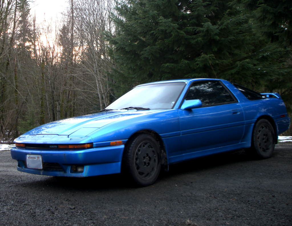

first supra 88 targa turbo:
after fixing enough of the previous owners stupidity(such as using a air compressor regulator as a boost controller and punching the cat "out" or rather into the muffler)and having it running good got dreaded rod knock!!!! so i planned on rebuilding the 7mgte with the help of my roommate who then stole my build money .
luckily i had recently met someone who was building a mk2 supra with a 7m. He was bored with the project and parting it out, so i purchased from him a fresh 7mgte longblock,mpt70 turbo,t4 manifold,exhaust pipe, wastegate, bov, intercooler with pipes, walbro255,aeromotive fpr,and ss clutch line. I then purchased a maft-pro and with the help of charles (gottadiesel) got her running good (still had stock injectors so i wasnt running much boost)
Then ..........while boosting up a hill the vacuum line popped off my wastegate (supra hit warp speed) and i melted a piston I did drive it for a couple months unsure of exactly why she was smoking soo much

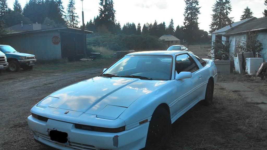

i found my clean 90 turbo shell in march of 2011 and began planning. I knew i wanted to overbuild this one. so the planning began...
when my eclipse was on its last leg i sold it and purchased a 7mge engine off craigslist and began driving the 90 supra
I am currently N/A So this is the new beginning...............
current picture
the current plan is
mpt70 turbo (purchased)
t4 manifold (purchased)
wastegate (purchased)
tial bov (purchased)
large intercooler+2.5in pipes (purchased)
plan on making my own exhaust
walbro 400 lph fuel pump (purchased)
eagle rods (purchased)
je or wiseco forged pistons
hks mhg
arp studs(purchased)
clevite bearings
ID injectors 1000cc w/clips
clutch ???not sure which one
megasquirt 3xtra w/mapdaddy 4(purchased)
wiring harness (purchased)
Knock module for ms3 (purchased)
iat sensor (purchased)
innovate wideband (purchased)
boost solinoid (purchased)
ss one peice DRIVELINE (purchased)
bc 264 cams
cry02 intercooler sprayer(purchased)
Megan track coilovers
valve springs and retainers
Oil squirters
Freeze plugs
larger oil cooler (purchased)
ls2coils(purchased)
Ffim(purchased)
longer throttle cable
sealed battery box and welding leads
bracket to drop alternator enough to clear intake while retaining ac......
