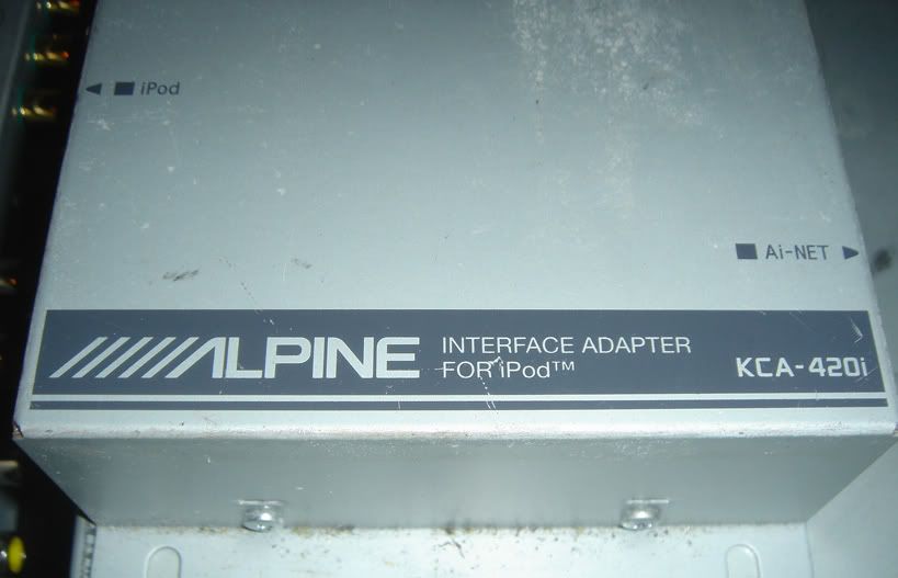

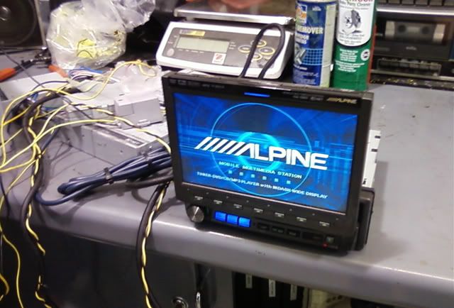

Here's my solution to ipod interaction.
Still gotta install the thing.. but not bad for twenty bucks:naughty:

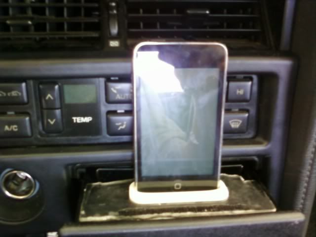

Here's mine, basically take the pin out of the back of the ash tray, drill a hole and insert the headphone jack cable through the back of the tray. Get a 90 degree earphone jack adapter and connect it to the cable. Take a piece of plexi glass and cut out the hole so the iHome adapter fits in and drill a hole for the 90 plugin to stick through. Once you've done that just epoxy it all and put the pin back in so it stops the tray from sliding out, it works great. Here's mine.

Don't you find it interferes with the heater controls?

gurley - are there adapter things available that will let you dock the itouch/iphone with a cover on it?
Looking at yours made me realise mine won't fit with the cover on :(
