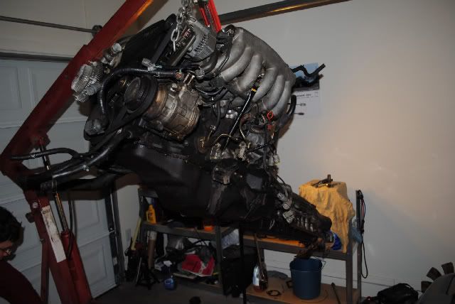

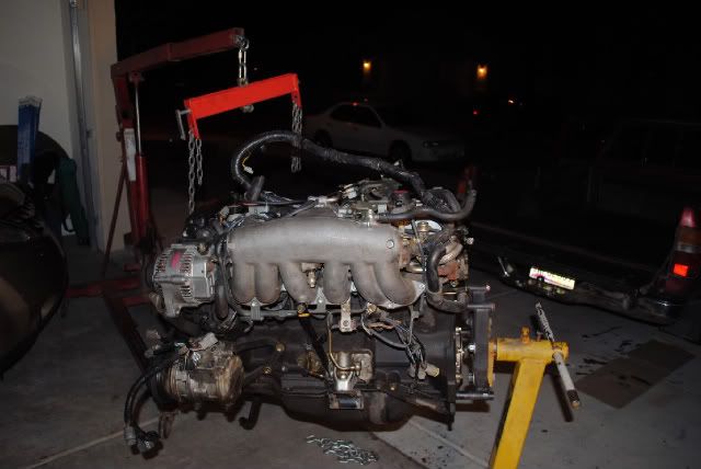

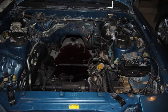

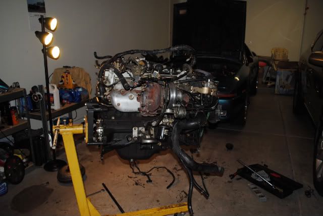

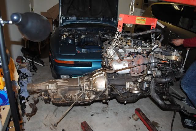

The 7m motor had 113K miles on it and I managed to update the intercooler and piping, put a ct-57 turbo in and install a map-ecu. The car had a general tune on it and I was able to do 14lbs daily. Never dyno'd it but estimated about 310hp to the wheels since it was a auto and did not have full 3 inch exhaust. Here is what the motor looked like last when it ran.

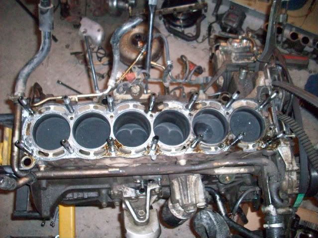

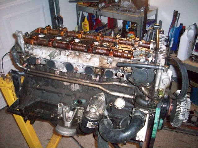

The coolant leaked forced me to experience all loss of coolant in the motor over a 150 mile trip one morning and I experienced no signs of over heating. (Let's not argue about this it was discussed in another thread) By time I noticed the leak the motor had over heated so much that the motor shut itself off and melted the spark plug boots for 2 & 5 cylinders into the head.
So as a result I pulled the motor to see what really went wrong, and as a result it was a small cut on the water neck hose is what caused the leak. The head was so over heated that it was visible that the intake side was about 1/8'' higher than the exhaust side when you looked at the back of the motor. When the studs were taken out the exhaust side felt they were torqued at 60lbs and the intake probably around 120lbs. The head was originally torqued to 85 when the HG was done at 101K miles. Also it looks like that piston number 2 experienced breaking of one of the piston rings because it is causing a major scratch on the cylinder wall.

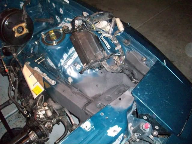

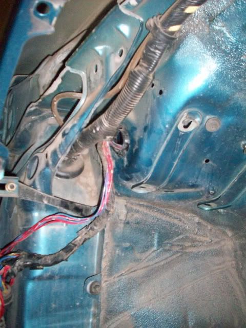

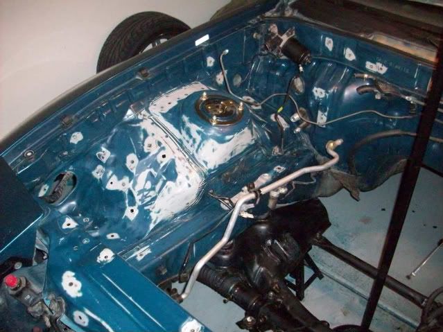

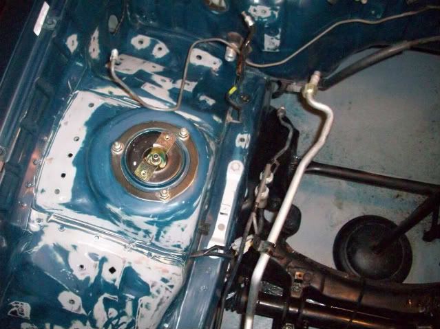

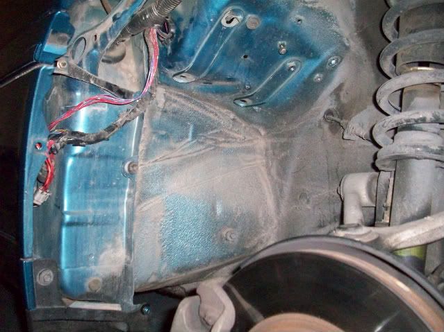

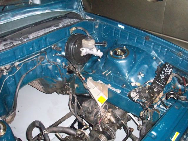

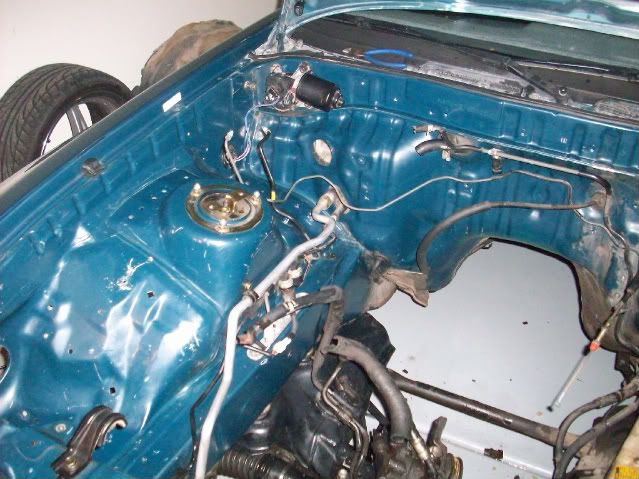

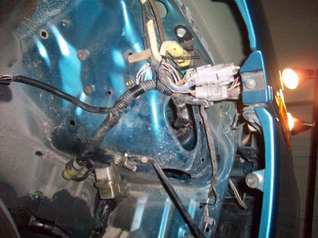

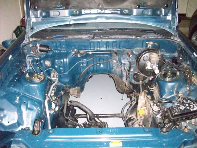

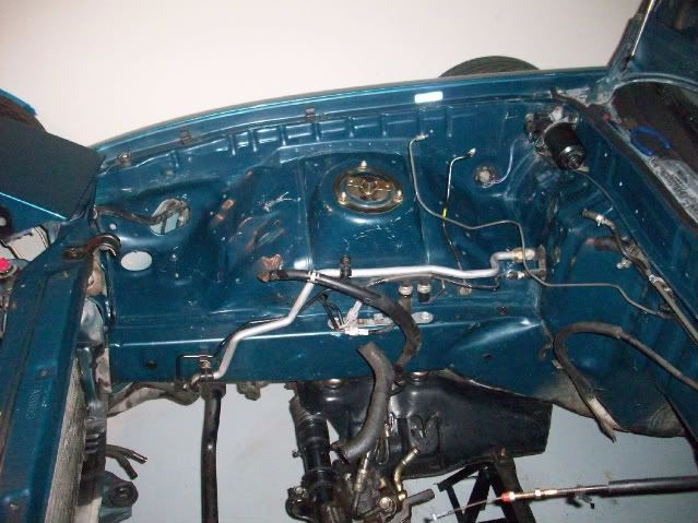

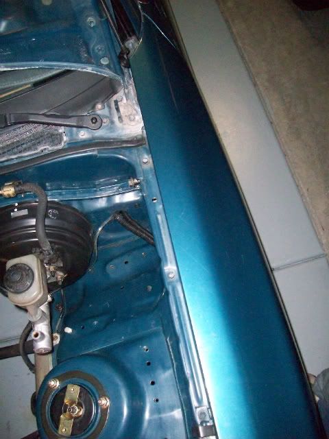

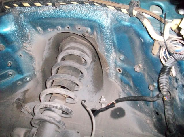

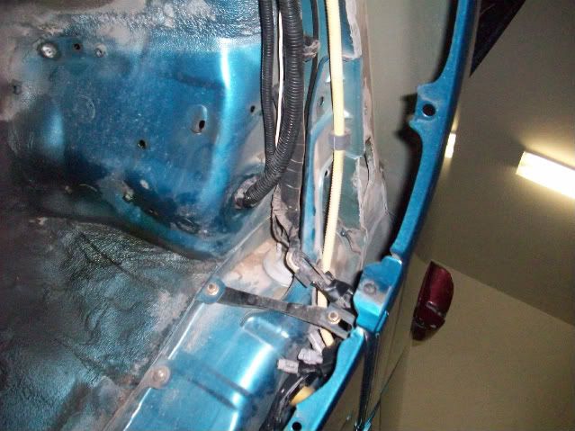

Update time, I was able to pick up some cheap mounting brackets and I also got a turbo rear sump set up from a local member for a great price so I don't have to do any drilling or tapping. The last two nights I have been doing a huge amount of work on the engine bay. First off I realized that the ABS lines were in the way of where I will have to bang the firewall in for when I run the twins. As a result I decided to delete the ABS system since mine was non functional. ( I know we have different opinions on this so just keep them to your self) The problem that I am facing is that I will need get the brake lines from a NA supra or make my own lines. Right now I got some tube bending pliers so I will see if i can make the pre-existing lines works.
Next I worked on the wire tuck, so far this was pretty simple. Most of the plugs on the passenger side where from the ABS so since that was gone I was just able to run those plugs under the fenders. I am also doing the complete 12v mod with relay for my walbro pump so that will get rid of the old relay and the resistor. On the driver side most of the plugs there were for the cruise control which I am removing so that fixed that issue with all plugs. I also ran my other miscellaneous wires through the fender as well.
But as of now I have the engine bay all cleaned and am going to start the wet sanding of the paint so that I can get ready for the paint and the filling of the holes. This weekend ill hopefully have a power washer to get the grime off the steering rack on under the chassis.
Day 1:
Day 2:

Ordered the motor today and should be here next week!!!
Heres the pics of the car with the sanded engine bay. I took the areas that are going to be bondo'd down to the metal and ruffed up the rest of the paint. I currently have everything bondo'd just need to sand it down. A fellow supra owner is letting me use his air compressor and sander this weekend so that I can start working on that. After I get the motor I will be sending the harness to get done, throw the rear sump oil pan on, rip off intake manifold, and turbo piping, and valve covers and get those powder coated. I will be doing that my self as my friend has a whole set up and oven, just need to buy the powder. Progress is a little slow right now but once the motor comes in it will pick up. Main goal is to be boostin by no later then the end of march!
