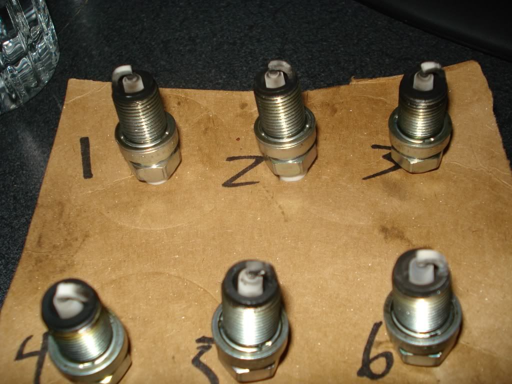

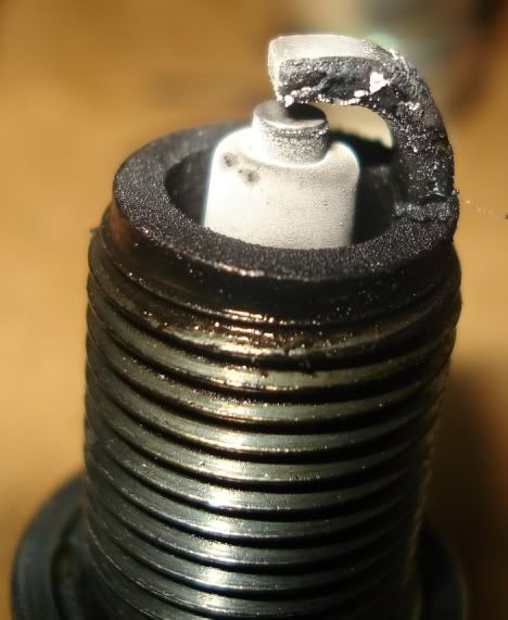

i did everything 'right' as far as machining goes... told them to torque the timing tensioner to 36ft lbs? (i had them write it down when i dropped it all off). Told them to surface below 30RA... and heres a picture of my spark plugs for all of you to enjoy. cylinder 3 is the worst out of the bunch... i posted a close up so you can all enjoy. the gap is still correct... but its got build up on it.

New rings and a different machinist. I wish you were local, I'd have Bryan Maloof look at it for you. Best machinist I've EVER had. And Jack Merkel used to build my motors, if that tells you anything.
