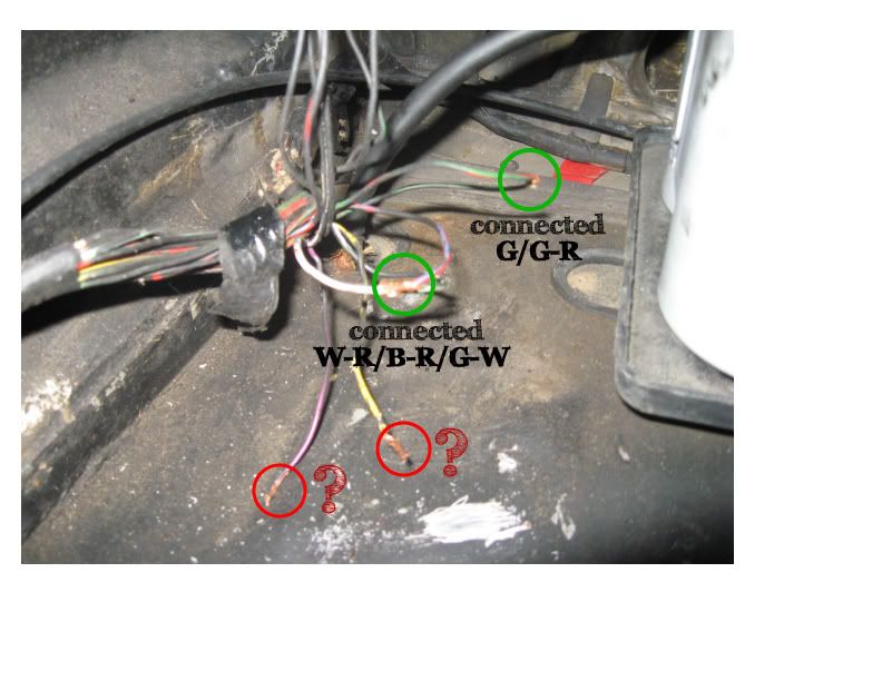

1) Locate and remove sensor.
The sensor is located under the drivers tail light. Unclip it from the body and then unplug it.
2) Bypass the tail light circuit.
Connect the tail light signal wire (Green) to the tail light wire (Green w/ Red Stripe). I reccomend using wire tap in squeeze connectors that way you dont have to cut any wires.
3) Bypass the brake light circuit.
Connect the brakelight signal wire (Green w/ White Stripe) to the brake light wire (Red w/ Blue stripe) and the the 3rd brake light wire (Red w/ White Stripe). Again all three of these wires are to be connected together.
4) Throw away your broken Tail Lamp Failure Sensor
Do not plug your sensor back in. Doing so will cause the annoying orange lamp failure warning light on your dash to stay on. Leave it unplugged ant the light will stay off.
5) Test your work
Turn on your lights and make sure your tail lights work properly. Have a friend step on the brake pedal, and make sure your brake lights work properly as well. Dont forget to check the Third (spoiler) brake light.
Now you should have all your brake and tail lights back, no thanks to that stupid sensor. Everything should work as it did before your sensor failed, however now when a bulb blows out your dash warning light wont come on.
