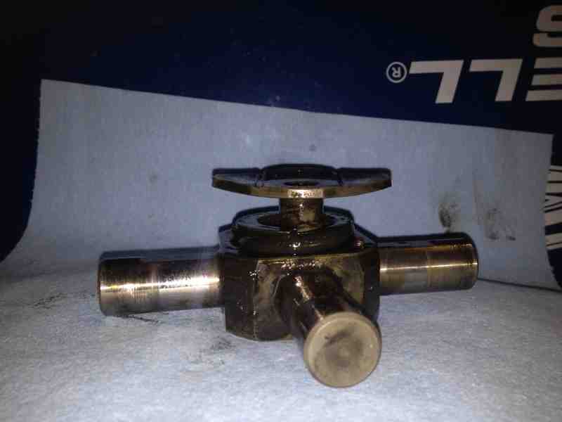

not ready for pics yet, but soon
however, we did find out what happend to the rear end. The spring plate that pushes against the outer gear got bent. It is supposed to be flat and it got potato chipped, which reduced the tension on the clutches and pretty much smoked them. We dropped in a used set of clutches with another set of spider gears and also added a spacer to the spring tensioner. Not really sure if it did much, but the better clutches really helped.
We took the car out to an event yesterday and hit a 1.47 60/ft. Maybe next time out we will hit it with a little nitrous.

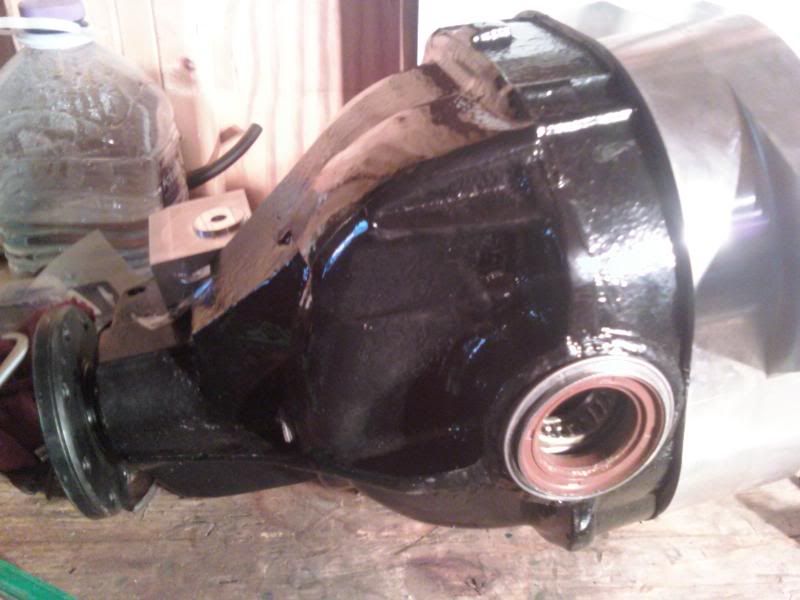

On the Mopars we run both an Iron and an aluminum version. The Iron are quite a bit stronger and work better with transbrake cars. I'd love to do this to my Supra as well.
10SecondC
Jun 19, 2012
15
north
Nice! Looks like there is plenty of room in the cradle. Who did you get to do the axles and what spline are the hubs? We use DSS for the axles and I was going to use them but if someone already makes them it would save time. Nice job on the housing. I assume you made the custom mounting points?
