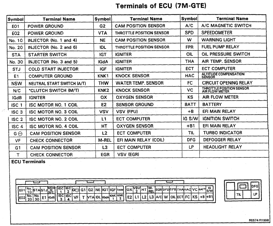

Ok so long ive only found this one, hope one of the experts tell me if its ok to use it or not
Stilll looking for :1zhelp: here :(
