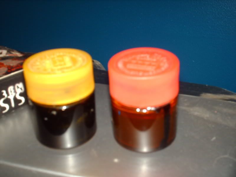

I used a nice looking red color, which I got from a local HobbyTown. I also snagged a yellow for the future.

Now, before we start, make sure you have all the items. I went to my local hobbytown, and bought the translucent Taymia (Sp) paint used for taillights on small R/C cars, or models. I'm not sure how any other paints will turn out, so ask others for advice on that.

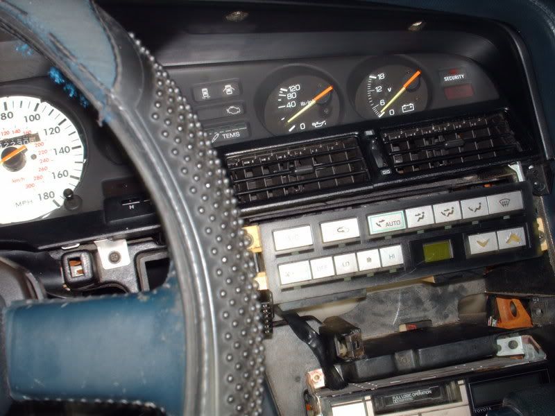

1. Start off by removing the climate control/ashtray/stereo surround. This is simply screws and pop-rivets, nothing huge. Make sure to remove the ashtray, followed by the 2 screws that are on top (You will see them) or it will not come out easily. Remove the female plugs from the male plugs on both the headlight washer button and the hazard light switch. Set this piece aside
NOTE: If your Supra equipped with an automatic transmission, this may require you to put the shifter in Low to remove completely.
2. Next, you will remove the 4 (or 3) switches on the left side under the dash (The foglight switch, coin holder, ect.) Remove a screw under the switch cluster (You will find it) and simply apply small pressure outwards to release all pressure on the pop-rivets. Remove the female plugs from the male plugs and once again set aside.
3. Now remove the Black piece above the gauge cluster. This is around 7 screws (4 or 5 on top, and 1 on each side at the bottom). Set aside.
4. Remove the gauge cluster. This is 4 screws on top of the cluster (You will see white things where the screws go into) and a couple screws on the bottom. Slowly and gently apply a decent amount of pressure needed to get the cluster to the back of the steering wheel. Separate the plugs and set aside.

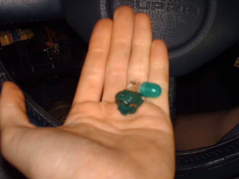

6. Remove all the (GREEN) bulb holders by turning counter clockwise and removing (There are 4 bigger ones and 1 smaller one) You know you will have the correct bulbs when you see a green condom on the bulbs.
7. Remove the condoms (One of mine was stuck on, and I scraped it off lightly with a screwdriver), but don't throw them away (You will see why at the end)

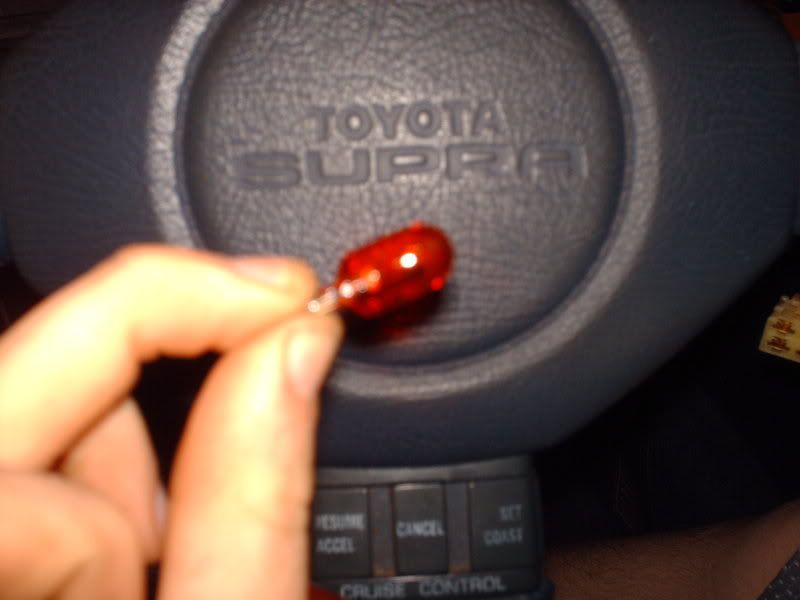

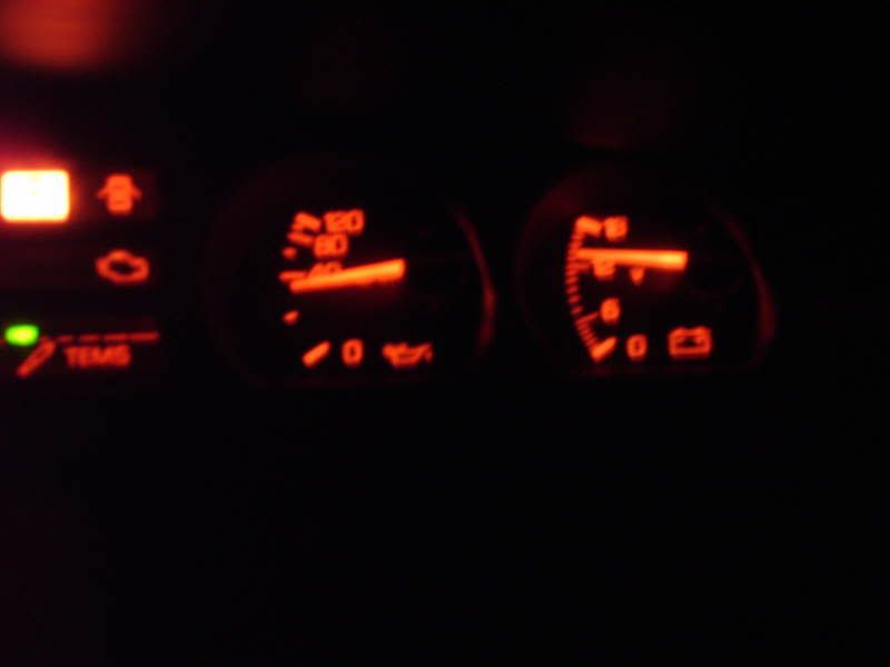

8. Now simply paint the bulbs with one thin coat of the translucent hobby paint, and once dried (Aprox 10 minutes) Add another coat. It should look like this. Be careful with this paint, IT ISN'T VERY FORGIVING ON CLOTHES!!
9. Put everything back together (Opposite way of removal) and watch them GLOW!!!
10. Take the green light condoms, find one of your guy friends (Or brother) and if they have a sense of humor tell them you found them some condoms that will fit them :D. I got a good laugh out of my brother, follow by a flying remote to the TV.
NOTE: When re-installing the gauge cluster, make sure the wiring harness doesn't get trapped within the male and female parts of the speedometer plug. This made my day long, until I figured it out!
Final product should look like this

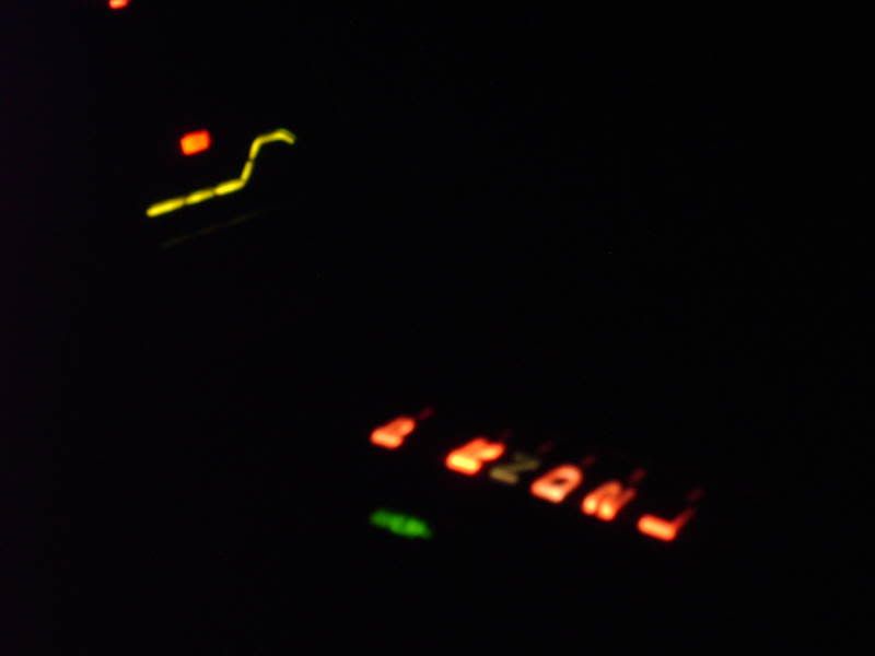

Changing the Auto shift Indicator color
1. With the stereo surround removed pop off the black indicator surround. No screws.
2. Now remove the 4 screws necessary to grab a hold of the indicator.
3. Remove the bulb the same way you would the others, turning counter-clockwise and pulling gently.
4. Remove the condom, and paint with 2 coats like the others were done
It should look like this when complete

looks slick, can you try taking a picture with a tripod and a longer exposure time? makes me wish i had done this when i had my gauge cluster out last month... maybe ill just take it out again :)

I might have to do this. Do you know if they happen to have blue paint for the bulbs? Also you could simply just buy the condoms in whatever color you want?

I heard that you can order different condoms, but I find it easier to just remove them and paint them.
Thanks everyone!!!
As far as the blue paint goes, I guess if Taymia (Sp) produces the blue translucent paint, why not?
I mean red works great, and is bright. Knowing that blue is a lighter color, I guess it would be the same if not brighter.

This doesnt look too bad. I like my BLue LEDs in the gauge cluster though, i didnt have to paint anything. But this is very good, the color looks more of red ish- orange ish. I like the color a lot, my next gauge im doing is going to be LED red.
