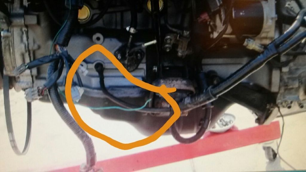

I am putting the last touches on my gte rebuild. I am trying to figure out where the following connection goes:
The wire circled in the picture is one of the two wires that comes off of the positive terminal for the battery. One of the connectors hooks up to the starter, but I can't remember where the other goes. It looks like a ground.
Thanks!

Looks like the ground lead from the battery.
Ground goes from batt to chassis and engine block.
Positive has a wire going into the harness and one to the starter.

Looks like starter to the battery.....the end running to the starter has a loop encased with a black plastic cap....the plastic cap will break off as it gets brittle which looks like the end that is not circled in your pic

Thanks man! Yep, you're right. I looked up some old pics of a previous build I did and saw that it was a ground that connects to the block
Got it hooked up. Just a few more things to do until I can fire it up
