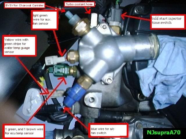

Need to know what these cables were supposed to be connected to. They had already been cut off when I bought the car, and didn't notice until quite a while later. There's 3 total, the 2 long ones and a really short one a bit further back. If you can't really tell the colors, tell me and I'll head down to the car to check.

The first pic is actually for the sensors on the water neck, the one w/ 2 wires goes to the blue colored sensor, don't know which way they go on though... the other two go onto the single wire sensors, I don't think it really matters which one it goes on, since they are both temp related BS.

Reference this. See if you have all these connected.
courtesy NJsupraA70
