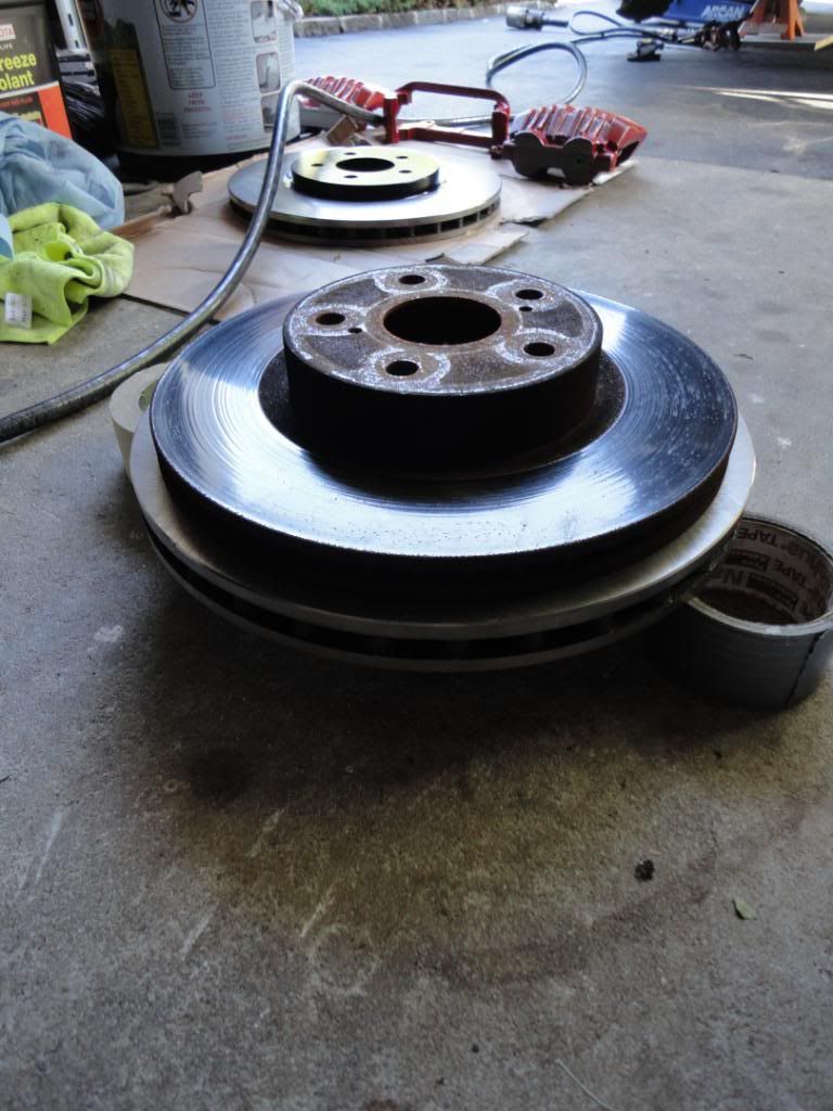

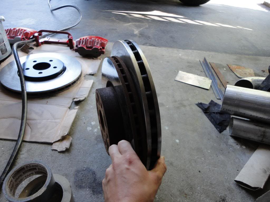

Im telling you the cobra brakes are night and day difference. They stop incredibly smooth and multiple times without change. Dollar for dollar best thing i have done to my car.
Pads will only make a difference untill you overheat the rotor. Pads cannot change how much heat the rotor can handle.
Heres a comparison of the stock to cobra rotor:
You dont realize the difference untill you hold both in your hands. The Cobra rotor is so much thicker its actually amusing.
