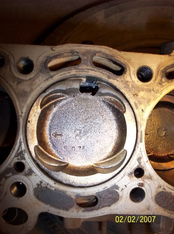

If you are not sure of your injectors flow, you will kill your engine. Like me
