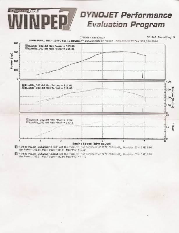

With bigger than stock exhaust it's gonna be all over boost cut. I recommend a bcc/fcd or whatever. Staying just under boost cut is pretty tough esp when even cold weather will put you over.It sucks!
Here's one totally stock with 3" dp and fcd no boost controller or anything!
Same car with powerfc no other mods. 332tq@only12psi!
Stock motors are pretty boss.
