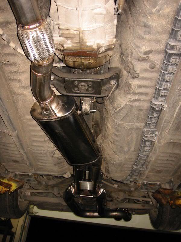

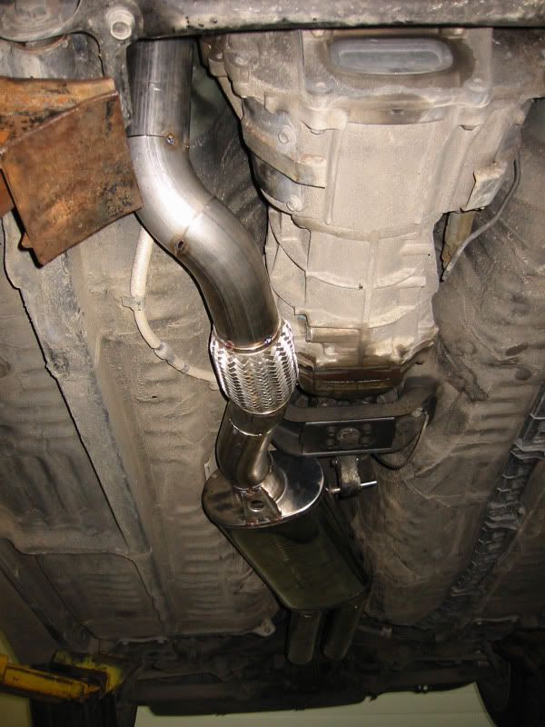

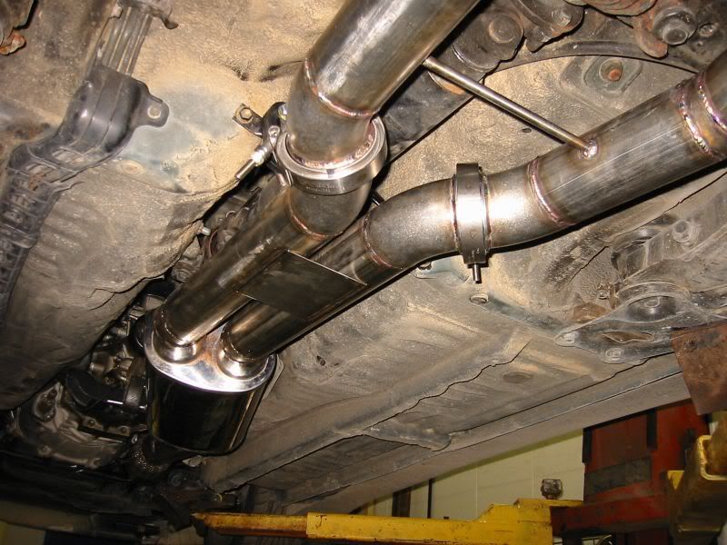

Down pipe mid pipe.
4" food grade 304 stainless.
4" then splits to twin 3" to gain ground clearance.
It has about 50-60 hours of work involved and about $1000 worth of materials.
This one of the best Pipe welding I have seen.:biggrinbo I love it

I hate the look of almost every aftermarket exhaust. This is a f*#($# work of art. I would never want to even kick pebbles upon it.
The sexiest MK3 exhaust ever created. Period.
