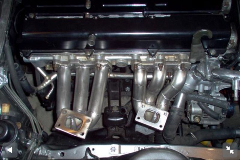

Who made 1jz twin exhaust mani

Bumping this in 2015. I am curious to know if anybody has housed the stock twins with aftermarket headers, hopefully with equal-length runners, because I have a set of Albert's twins and I'm trying to justify how restrictive the cast iron exhaust manifolds are.
Because of the capability of the twins and the fact that they appear stock, I want to help these puppies breath and want those upgrades to appear stock as well. A larger intake will be designed since it has been proven that the stock intake arch is restrictive, and I will be purchasing my upgraded 'Y-Pipe' from the guy who proved this theory. Here is the Dump Pipe (aka Y-Pipe) as part of this kit he fabricates to run CT20 twins on a 1JZ;

But I was posting about the cast iron headers and not the Y-pipe.

As said, if you are throwing away all the plumbing that goes with the stock twins... you might as well go with a more standard modern single turbo.
I upgraded my stock twins but that's only because I wanted to keep all the rest of the Y-pipes and downpipe and stuff stock.
If you're throwing away the stubby little stock cast iron manifolds, everything's custom, and keeping the ct12s makes a lot less sense...

My point was just, once you change away from the oem non-equal length stubby exhaust manifolds, NONE of the OEM or bolt-on Y-pipes, hot merge pipes, etc will work anymore, because the turbos have to be relocated. There is no way to have an equal length header that keeps the stock twins in their stock position -- there's just no room.
IF someone doesn't mind doing all kinds of custom work to use a pair of ct12s in a different position, on equal length headers, then more power to them! It'll just be relatively costly + difficult compared to going single or keeping the twins in their stock position and reusing stock parts... and it's about the same difficulty as just forgetting the ct12s and using GT28s or something.

You raise a very good point, as it would disruption to everything else if the twins were to be displaced. I've looked under there before and there isn't much space between the head and twins at all. The middle runners would have to run down and back up again, but would still require a reasonable radius. Mind you I would have the whole TT system assembled and floating in place while routing and tacking the runners in place.
My oil feed and return lines have been converted to AN fittings. I should be able to move the whole TT assembly over a little but not much. I was thinking I might have to move it away from the engine but not enough for the new gap to become noticeable, also because the heat shield is suppose to hide everything. The downpipe can be worked on at home and the HKS intercooler piping does give a bit of flexibility.
I know it is very questionable and would have to speak to my aluminum welder about it. See what he thinks of the cast manifolds when I bring him a set of blown twins as a mock up for him to do the intake. I've seen him make some very nice headers before and if he says I wouldn't be happy with the flow, I'll ditch the idea and port the cast manifolds instead. I came here to see if anyone had done it before.
