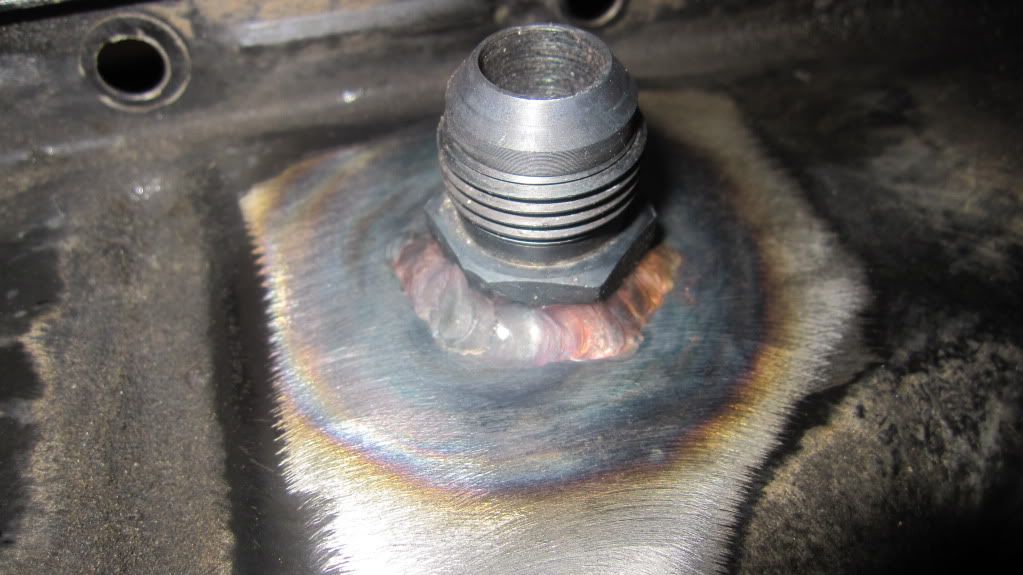

I am going to be welding in a -10 AN steel bung into my oil pan for my NA-T build.. Anybody have a pic of where they welded theirs in for the best fitment.. I am automatic so have the transmission cooler hard lines right up against the block.

Devin LeBlanc;1633131 said:
You obviously don't know what your talking about.. Unless your oil pan is different from the 3 I have here that are all highly attracted to a magnet
You're correct. For some reason I had a brain fart and thought my rusty pan wasn't steel. My bad for misinforming anyone reading this thread.
63
Devin LeBlanc;1633145 said:
Yes, It will be for the turbo drain, and the feed I got a T for the oil pressure sending unit that adapts it to -4 AN
As high as possible and in line with a Main Bearing cap as Oil flung off the Conrod WILL block the drain enough to back Oil up into the Turbo and cause the James Bond smoke screen while driving.

Had my brother weld in the oil drain bung.. Good to go, now to throw this motor back in the car!
