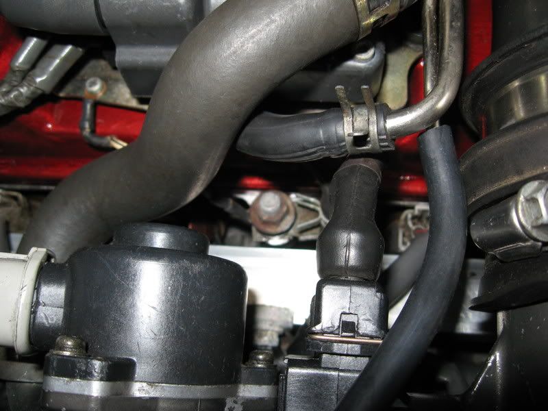

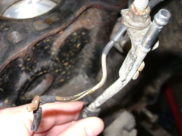

I was taking off my fuel rail when i found this wire that i cant seem to figure out where it goes. My guess is that its a ground for something, it is bolted to the fuel line. Does anyone know where this goes?

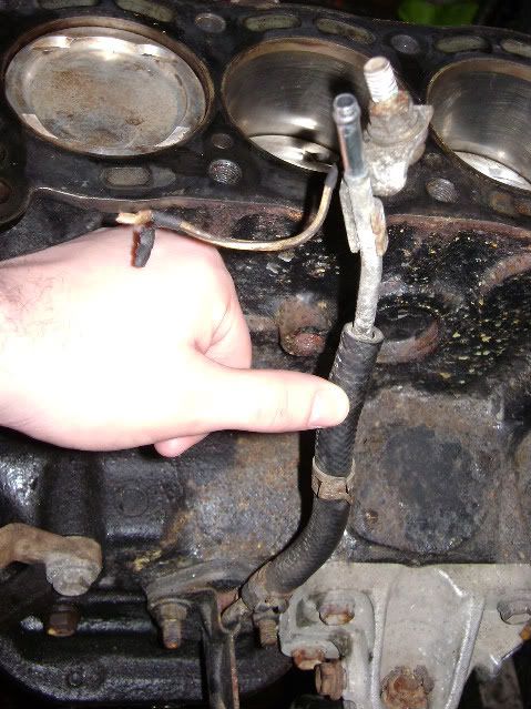

its the ground for your coil packs

That is the correct place. The bolt that the wire is connected to gets bolted to the head iirc. The end that is severed gets screwed into the coil pack mounting via a really small screw. It appears you are missing the connector for that side, though.

Where it connects to the coil pack (small phillips head screw):
Where it grounds out (dead center):
Hah looking at the I should probably make a new one of those wires...
Oh and I just realized something in your first post, the hardpipe doesn't go to the j-tube fuel line. It is actually just a vacuum hardline for the BPV I believe.
