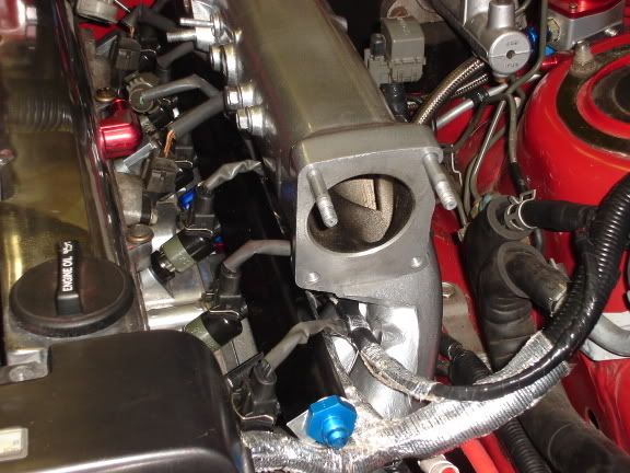

Is there some secret to get the damn thing off? I've got all the bolts, peripheral mounts, vacuum and coolant lines disconnected. The manifold is loose but i cant get it back quite far enough to clear the studs. Anyone who's got this thing off care to throw their $0.02 at this post?

its the biggest pain in the ass ever. You gotta take EVERYTHING out in that aera pretty much. The wiring harness goes through the intake and you gotta get all the wiring from that section off and it has to go through the small hole in the manifold.

mine was a pain in the ass nbecause of the wire's that go through the upper plenum.after doing injector's i ran all the fuse box and ignitor wire's out the front under the TB.

With out a doubt im going to be re-routing the engine harness. I never wanna have to go through that again! I guess it was for the better anyway. Gave me a chance to get my engine harness out. Now i can get er' all cleaned up... One of my pet peeves is cluster fucked engine bays:aigo:
