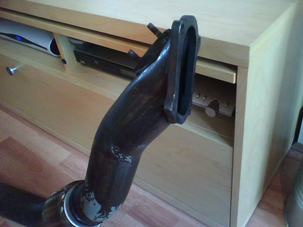

300HP is easily attainable with the stock turbo.
I'd mke sure to get a good downpipe, prefurably one that replaces the elbow as well as that will show the largest gain.

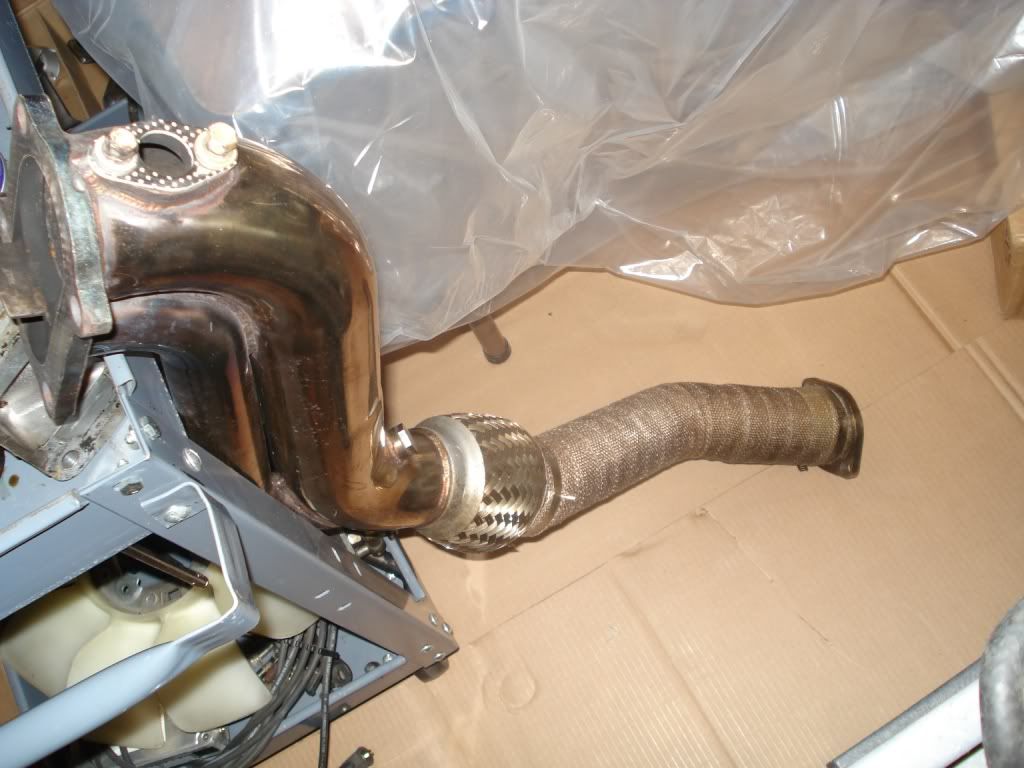

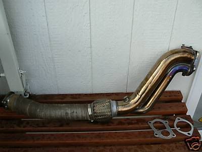

Titan down pipe like this is excellent replaces turbo elbow, along with this i have a 3" Tanabe system and HKS vpc, boost went to 11.5 psi BEFORE boost controller used!
