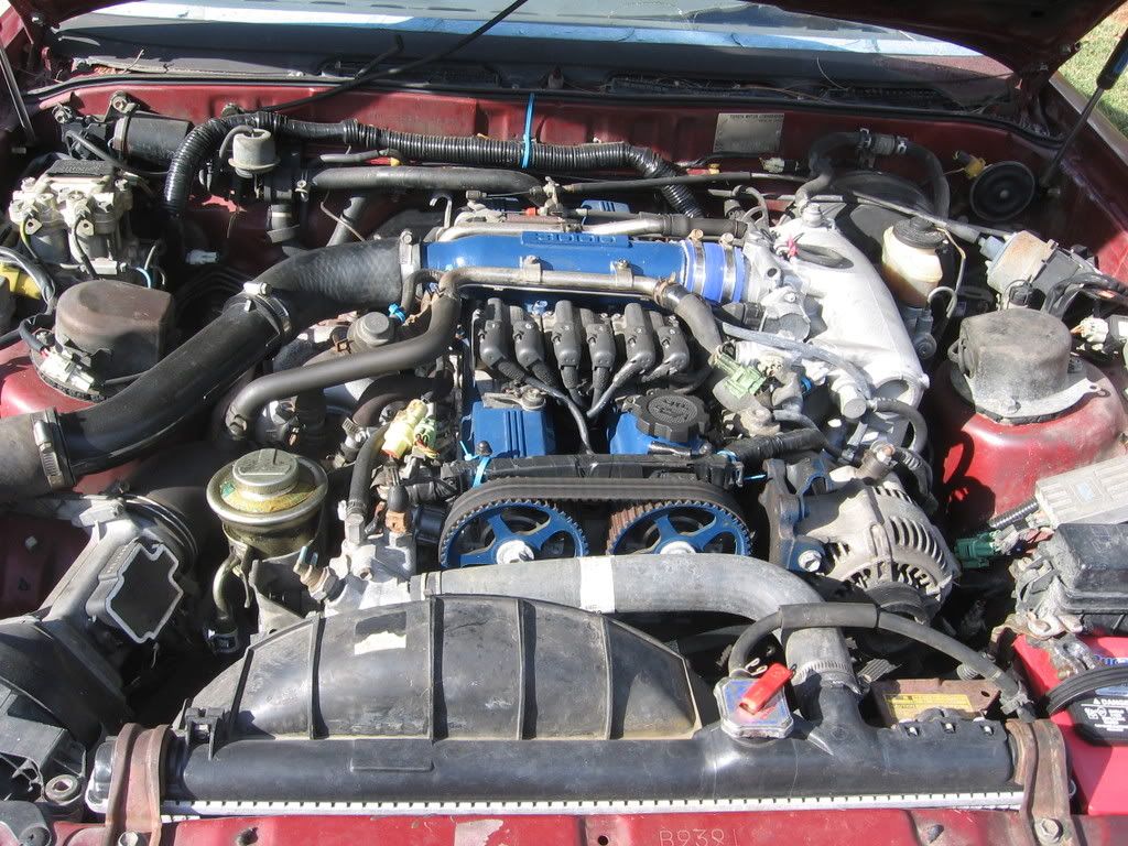

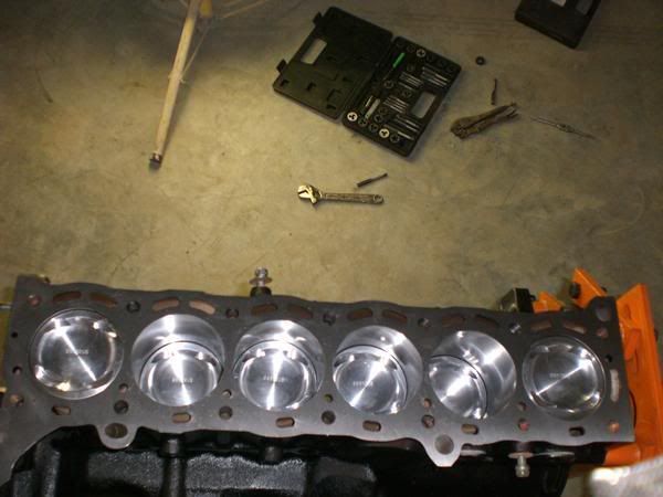

I never got around to making a build thread(maybe i still should) so here are some photos of my build. Machine work done by Womacks Machine Shop in Baton Rouge, LA and most of building work by Pro Performance in Baton Rouge,LA. Honed out, ROSS pistons, Ported Head, balanced block, Cometic MHG. Everything else is mostly stock. Has gutted cat and cat back to Flowmaster.
Before
In between
Complete

your motor looks rock solid with the internals you used. but as mentioned before, you major restriction is going to be your exhaust system. the stock exhaust and downpipe are a major restriction. so even if you up the boost, you wont see great results.
