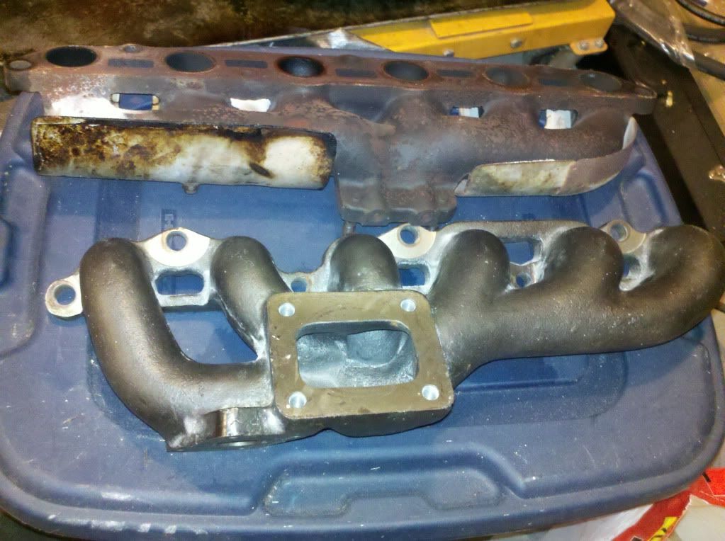

I just picked up a T-4 manifold from a guy. He says he bought it a few years ago from NOPI, and it's brand new. Problem is, I'm not sure what size wastegate will bolt to it.
The manifold is a HKS log style, like the 'Treadstone' units made now, though I don't know the manufacturer. The mount is rectangular, the bolt pattern in 68x44mm, and the wastegate hole itself is approximately 32mm. I assume that its a standand 40mm WG mount, but want to be sure before I order one. SO, if anyone knows, or if they have a WG sitting around, maybe they could measure the bolt pattern on it?

some hks 50mm's use the rectangular mount, there are also some ebay wastegates that will mount up to these but i would never recommend those ever. If all else fails go the rout i went and just cut the flange off and reweld a new one on or try and find a adapter. most newer waste gates use a v-band connection i know i've seen this in almost every brand. But the brand of wastegate all depends on how much booooooooost your gonna run and i think power goals are in that mix to.
get a picture of the manifold and maybe we can help you more

Interesting manifold!
Looks like an adapter plate is your best bet. Doesn't look like a 50mm HKS style would fit.

Well, it appears to be a direct treadstone knockoff, or it may even be a treadstone- I don't know if they
put a logo on theirs. the Treadstone unit is supposed to take either a 40 or 50mm. I dunno.

it looks like a 50mm to me, do you have a set of dial calipers? if so measure the over all length and width of the mounting area, then the bolt pattern, and the radius of the waste gate hole itself

according to the pictures on Treadstone's website, that looks to be a Treadstone manifold. The 7M mani doesn't seem to have their logo on it.
The site also states that it uses a HKS 40mm or 50mm wastegate
