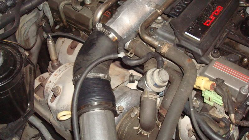

Just about to finish up 7M GTE rebuild with some mods. After market intercooler and pipes, the "3000" replacement pipe does not have bung for hose that goes to the vacuum switched 1/2" hose that I don't know the function of. Does someone have a diagram of all the vacuum lines and what is needed and what can be safely deleted? Thanks. (FWI, I am using the replacement turbo elbow and full 3" exhaust from Driftmotion)

That thing you don't know the function of is the factory bypass valve (blow off valve) and you should have one, factory or aftermarket.

Perhaps I was less than clear, since I don't know what the hose in question is for. It is large (1/2' id) and runs from the 3000 pipe through a vacuum operated valve then to the accordion hose. I don't see it in the routing diagrams you so kindly provided.

That's the factory bypass valve, or BOV. It will have two big hoses, and You need it, or an aftermarket alternative.
This thing, two big hoses, 1 small vacuum line:
