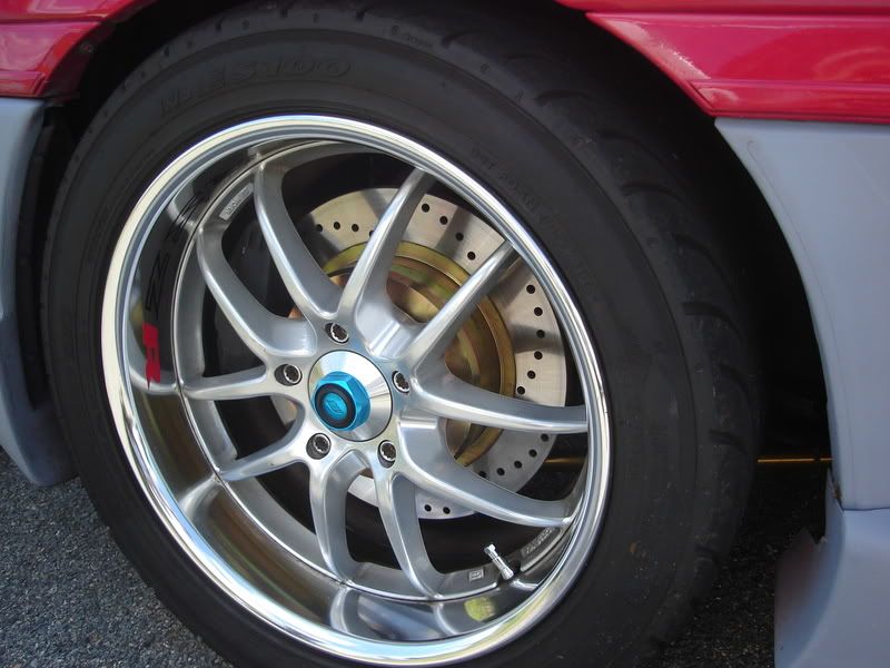

Oh 315's are very nice, here are some pic's for you guys.

i have a set of stock rim's with nitto extreme's and a 17" with a 275 on it.just by eye it look's like a good strong inch taller.i know it's only a small difference,but when added to the weight factor:(.
my work meister 17" with a yokohama 275/40 is 52 lbs and the stock five spoke with nitto extreme 225/50 is 37 lbs.
i know it's nit picking,but i was just stating something i believe to be fact.
i think the biggest issue is he want's a 10" wheel.even the 275 doesn't seem to fill up that size rim.i like to have my tire give me atleast some protection against curb's:)
this is my 17 x 9 with 275/40.there a perfect match size wise IMO.
