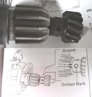

ok just one more question. im not sure where top dead center is on the Camshaft position sensor. i just dont want to put it in wrong or mess anything up. im going to be setting the timing and putting the sensor in tomorrow, if my turbo comes in on time. i have the crank and cams all at top dead center, just ready to get it back on the road after the blown head gasket.

those hoses suck..no offense just that ive been through it.when they heat up they sometimes suck into themselves and some may melt..just a heads up and as for timing,time it to specs..and also as for the timing marks 0 deg on the crank pulley then the cam gears have lines in them that you match with the lines on the rear timing cover on the head and lastly set the cps accordingly..gl with your project!

Now that you have all the timing marks on the cams and crank lined up. Hold the CPS in your hand and turn it to line up the timing marks on it. You will have to eye ball it when going into the head so its in the middle of the adjustment range.
The CPS will turn as its going in because of the spiral cut gear. But make sure the housing still stays lined up. Its kinda funky to get it right but once you figure it out your good to go.

ok i found the answer to my second question.http://www.supras.com/06/techcenter/images/881.jpg

im not sure if this is how the CPS should be at TDC. im just trying to do it right the first time.:aigo: its driving me crazy now, this is the best i can get it to line up. i lined it up to TSRM. just not 100% with this CPS this is the first time with a car with out a distributor. any help would be great. Thanks
