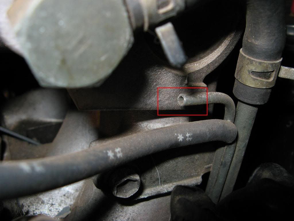

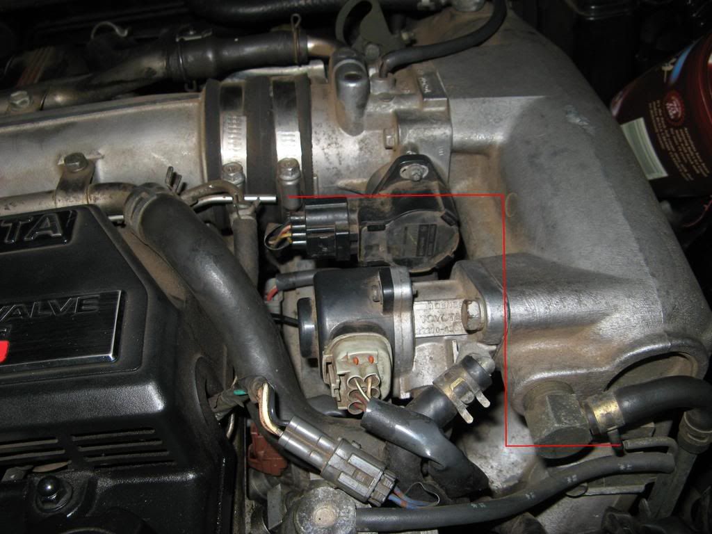

What is meant to be here!

Yep, came from the factory with them.

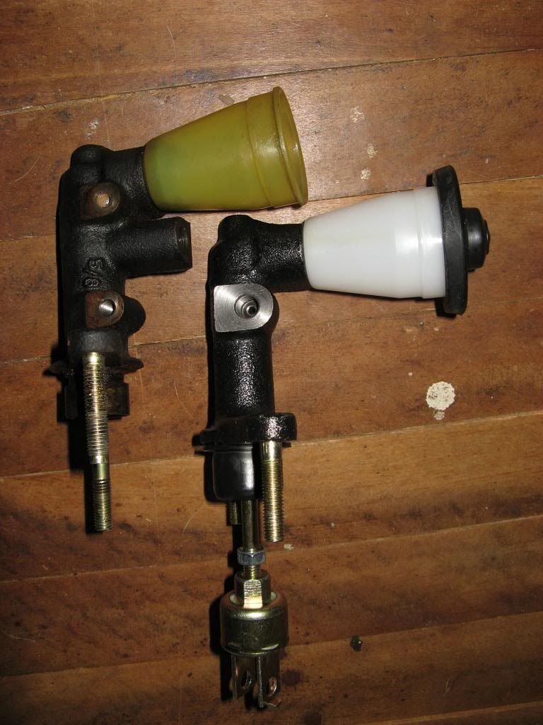

UPDATE: got my new master cylinder today, is very different to my one that I have now. So I have to now get a refund and take my old cylinder to a hydraulic sleeving service place. They GUARANTEE same day service though so it might pan out okay. Pics as always !
NOTICE ANYTHING DIFFERENT?

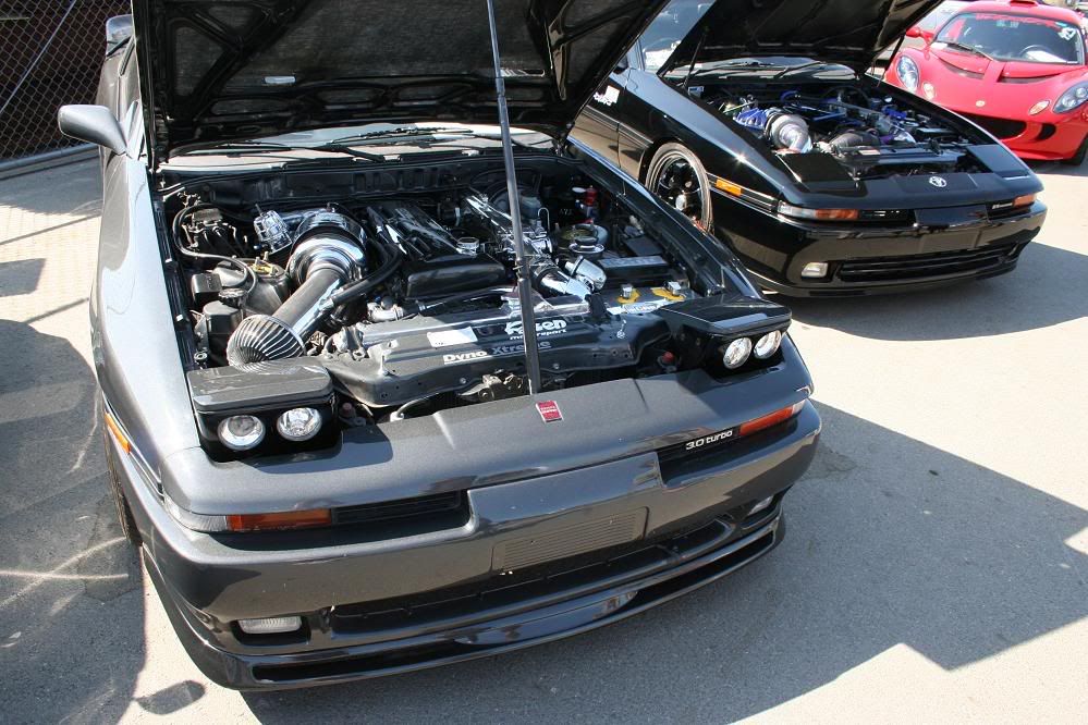

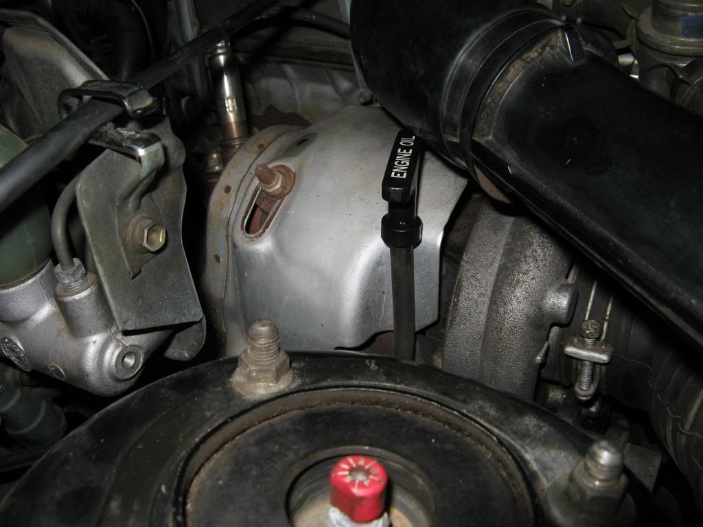

Nice turbo A. Not very often we get to see this rarity around anywhere
I like the look of the stock jza70 Lip. I picked one up recently too Zum.. lol
I also noticed you have the trd adjustable shocks...I aven't been able to find a set apart from the one I had on my last supra. I guess turbo A's came with them from factory ??

I called toyota but am not in a position to wait 2-3 weeks. Getting it sleeved first thing tomorrow morning, they guarantee same day service and is free if they do not do it in a day.

We already figured it out. :3d_frown:
It takes an understanding of what those lines do, and he being a JDM spec supra doesn't need it.

All good guys, on a good note, got my refurbed master clutch cylinder in tonight, took a while to bleed it properly and get clutch adjustment perfect but was a winner in the end. Feels a heap better. Changes are smoother, clutch is heavier, only good things to say in this announcement!
Will post pics asap!

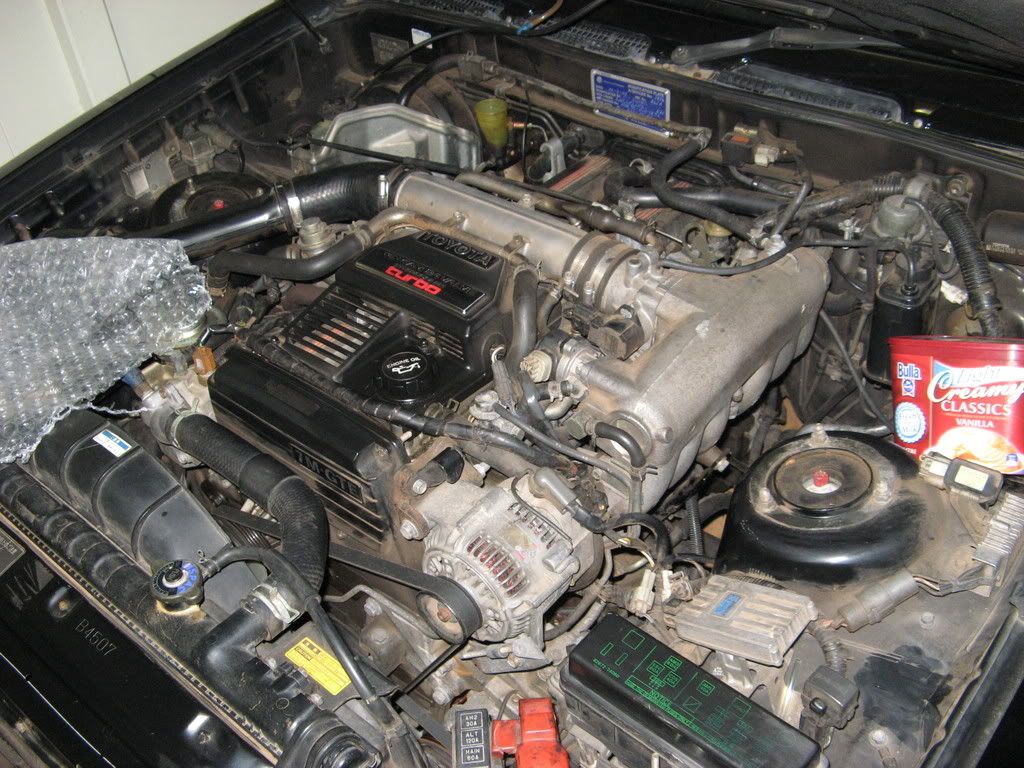

[thumb]http://i162.photobucket.com/albums/t269/pinklightfever_jdog/TurboA01006.jpg[/thumb]
Most impressed that the turbo-A comes with a half-gallon of vanilla ice cream.
Can't believe no one else noticed..
What can I say? I love ice cream!

I have the Turbo A catalogs, so if you have any questions, just ask. I'll see what I can do.

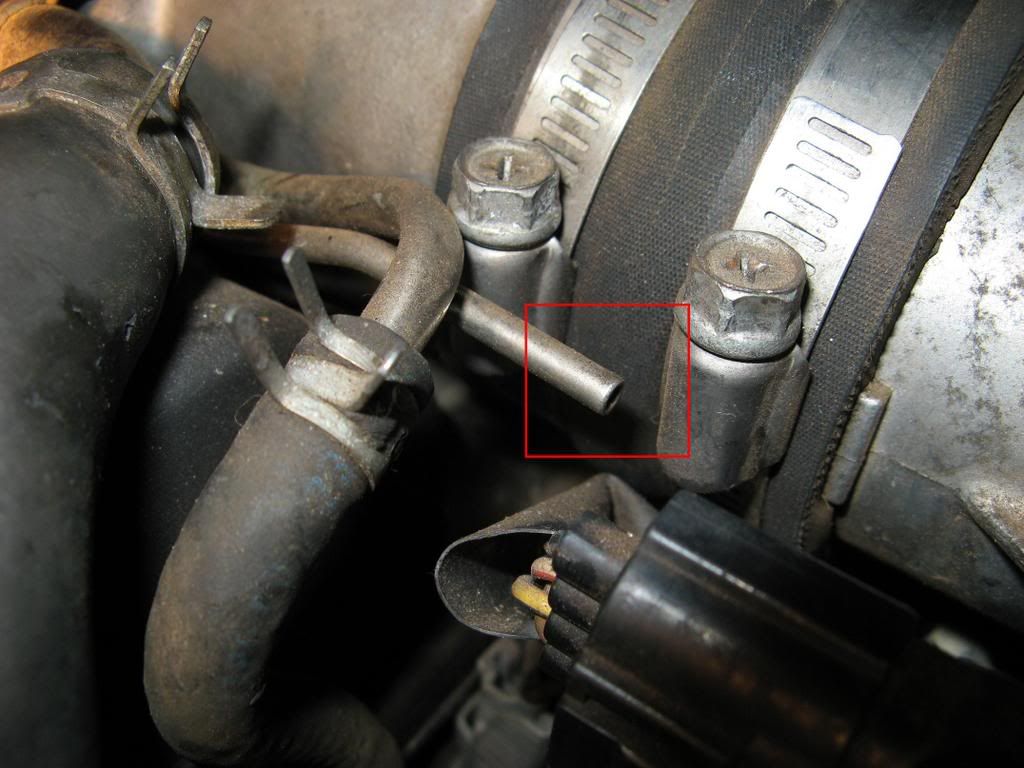

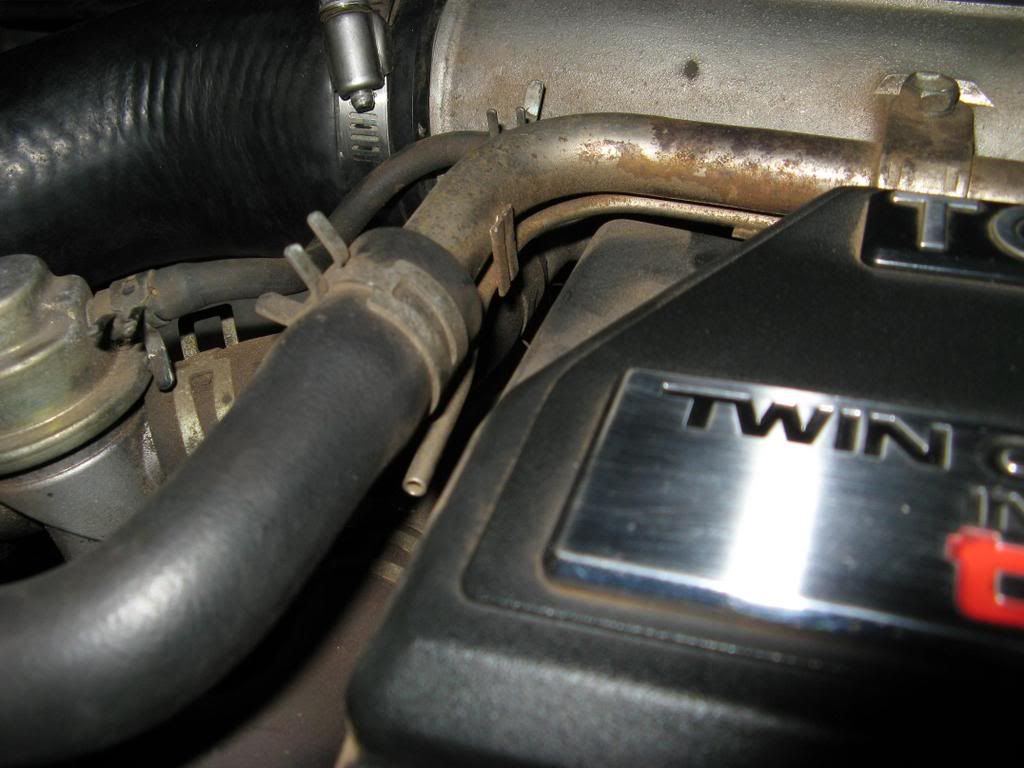

As for the vac lines, even though it was already answered, I thought I'd post anyways, I checked my diagrams, and it looks like (as was previously stated) nothing goes there. :)
As for the master cylinder, they gave you one for a GA70 N/A, lol. You should have gotten you one for the MA70 (which are the same style as yours, nothing special about them for the Turbo A).
Ahh well, as long as it turned out in the end. :)
