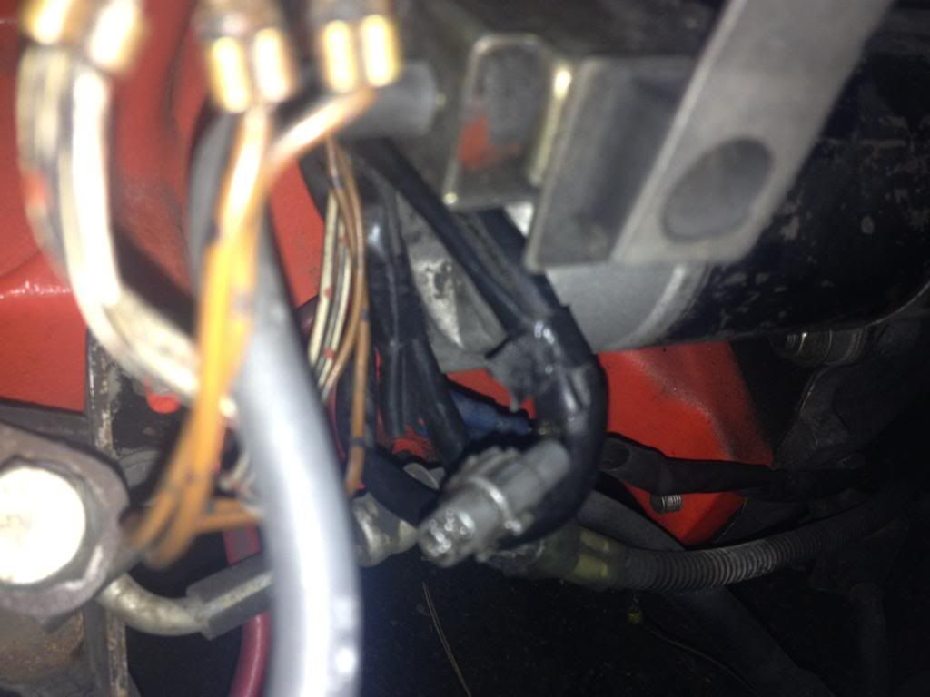

Hey guys, I'm new here, and plan on becoming an active member. I drive an 89 Turbo Targa, and have some plans for it. This is my first Toyota fresh out of the Honda scene. I've been reading up on the dreaded "code 52", for the knock sensor ( as my car is throwing the code ) so I looked on here to see where they were located and noticed a plug that was just dangling there. This is right under the intake manifold, near the rear KS. I'm wondering if this has anything to do with the 52 code I'm getting, I'd like to know before I start to tear the IM off and buy rewire stuff. If it's not to the KS, all well, then what is it to? Thanks in advance guys!

There is one that goes to the tranny. that plug is a generic plug that is used multiple times in the car. its the same as the heater core valve, the pps, and there are some other places that use that plug. what would help more is the color of the wires.

that has nothing to do with code 52. could be the reverse lights, do they work when you put it in reverse?

True, but the heater core valve would be on the opposite side of the engine, and the PPS would be at the front of the engine.
The wires for the reverse lights would be red and yellow, at least on the '88 they are.

Many times, the code 52 is from one of the two knock sensor plugs being disconnected or the wire being broken. Check for this at both sensors.

lol.... I know it wasnt the hcv I know where its located. its either the pps or the reverse lights they are in the same area. my point was shiw us the plugs, and the wires for a positive id.
