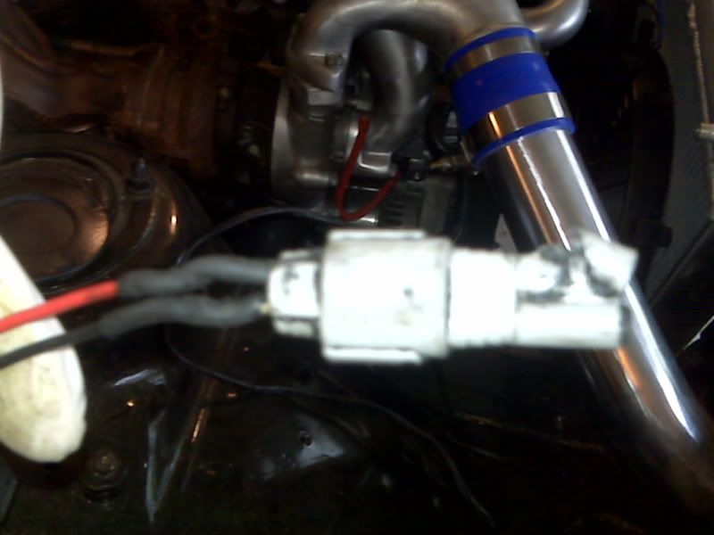

This plug is on the drive side of the harness. Not sure where or what is goes to.

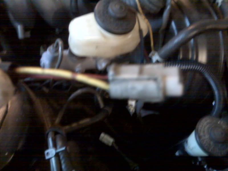

These Two plugs are on the same side as the first plug.

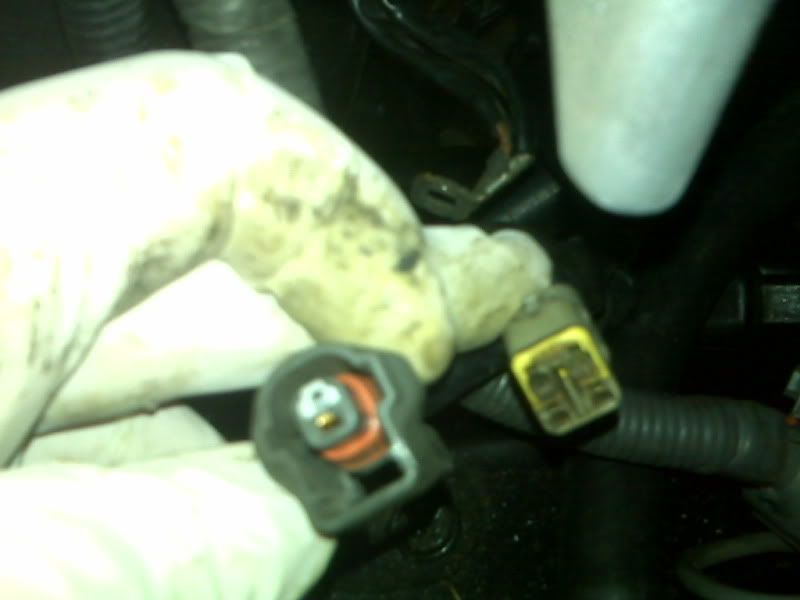

The wire on this plug is crazy long and plug is broken but still need to know what it goes to

3rd looks to be reverse lights. Plug looks broken on the snesor side too.
Second looks like newer abs or something and the other single wire could be knock sensor if its at the rear.

1-reverse lights
2-single wire is knock sensor(rear) 4 plug is abs
3- is a hybrid as in it was messed with before. at the length you describe im gonna take a wild guess and say the power steering solenoid since the 1j harness had it on the right hand side for jdm cars. looks like someone extened it for the right hand side
