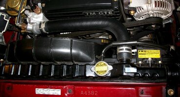

I'm in the old-school green concentrate antifreeze camp. I have an aftermarket CFS copper brass radiator. Napa makes a green concentrate that's made for cars before 1995. I mix it 50-50 with Walmart distilled water. 1 gallon of concentrate mixed with 1 gallon of distilled water will do the job. It has to be to changed more often than the red though. The initial pH is around 10 and when it gets anywhere near 7 it's time to change it, or 3 to 4 years. I got a digital wet bulb pH meter to keep an eye on it for under $10 on eBay . I keep a log book of all repairs and record the initial and follow-up pH values. The upper radiator hose I'm using is for a MK4 cut down to fit. It was cheaper and easier to find on eBay.
