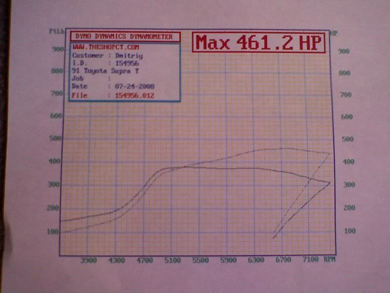

That car has a problem, the boost is coming on way too late which is why you are struggling to launch it. I would check for a boost leak or a pre-turbo exhaust leak.
Could it be the fact that I'm still running stock cam gears? Ie too much overlap?

There are many reasons the boost could be coming on so late. You have to figure it out. Start with a boost leak test before dropping even more money and throwing more parts on the car that will complicate things further. Then take your tester and plug it on your exhaust. Tiny seapages here and there aren't hurting you, you will really hear any obvious leaks that would be however. Make sure the wastegate is working properly, and hooked up properly, make sure the boost control is a good one and working properly. Start with the basics. I wouldn't be throwing that antilag on until you figure out what the problem is with the car first. If you do a 6k rpm clutch dump and the car bogs, something is def not right.

Well how can I launch hard when car loses boost as soon as you let the clutch out. I don't like abusing the clutch either especially since I paid almost $3k for it.
