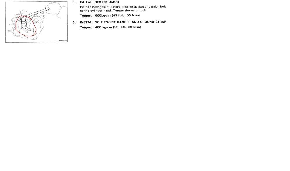

In the process of switching over parts from my old head to a new, re-furb. head I managed to sheer off the bolt in the banjo fitting on the back of the head.
The old fitting was corroded, so I'd like to get a new one anyways.
Does anybody know the part number? Or have a used, decent condition one?

90401-22004 should be it. Might want to pick up the gaskets (2, 90430-22008) to go with it. It isn't much but it is dealer only to the best of my knowledge.
